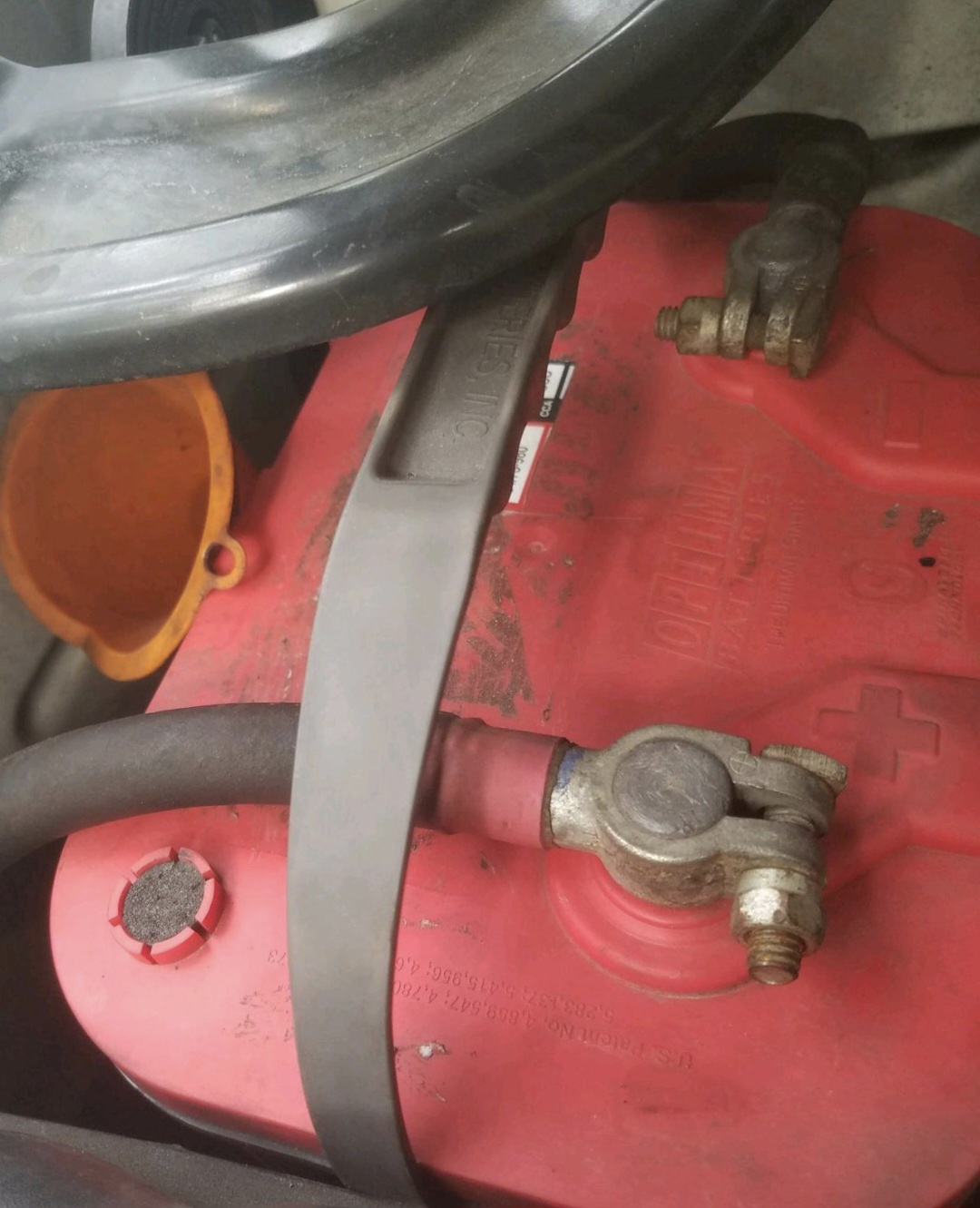

for my dual battery setup I just bought the cable that goes from the 2nd battery to the starter and ran a ground over to the 1st battery, I believe I also ran 2 cables off of the alternator one to each battery.
that is "parallel" and it doubles the amp hours and cca's
other options include using a isolator like many rv's, boats or car audio use, some are automatic and some are manually switchable.
just choose one that will meet your anticipated amperage needed.
I would love to see some pics of your dual-batt setup, too!
Tahnks!
sure once I get the engine compartment cleaned up it's about time for me to do my semi annual engine compartment cleaning. had to take a couple long trips thru rain and snow and pretty much treaded water with it so it's due for a pressure wash.
Nice!! I would have done the same thing! :D
