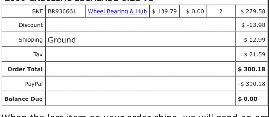

Dropped the hammer on the majority of the parts needed for the front end rebuild. This was a dent to the pocketbook, but all in the big plan. It was the reason for selling the 08 YXL Denali a few years ago. If I was going to rebuild the suspension on a keeper vehicle, I'd rather have it be an e85, non-AFM truck that didn't need a total respray in black because GM's clear coat disintegrating.
BTW the GM Part Number: 19420992 above had Supersession from the old MagRide strut #19353951. R/A doesn't share that info but GM websites do. BTW the current dealer retail on these is $681.82 ea.
R/A won out on the majority of the parts ordered because of pricing, shipping and that awesome 5% discount that more than offset the shipping charges. The OEM MagRide/z95 were only $309.79 ea for the fronts.
I'll find out when the strut mounts come in if they're really needed. I can't tell if there's an internal rubber bushing sandwiched inside the part or not. Obviously if there's no rubber bushing, I'll return them because the metal caps don't wear.
So far the part scrounging, including the updated list of Aluminum suspension and their bushings on the 1st page totals $1,522.17.
