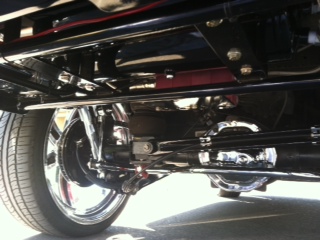

I have Universal Strut bags on the front. They replaced the springs. I'm running Belltech adjustable struts but their not needed.
The rear I have Conitech bags.
Mine sits on the fenders front and rear on 26's. Heres a few crappy pics.
