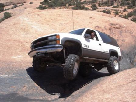

I did a SAS on my 94.
Fabbed up by me and a buddy,
GM D60
14 bolt
4.56's
Detroits front and rear
2.5" skyjacker springs front and 8" rears
swapped Tcase from a solid axle 'burban(NV241)
Slip yoke eliminator,
Custom Crossmembers and skid plates
Hydraulic steering assist
winches front and rear
36" iroks
I lucked out cuz it works great on the trails, and handles pretty decent on road all things considered. Let me know if you want more pics of the specifics, happy to help where I can.
