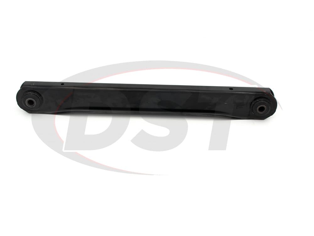

Flipping the script. Looking at Moog upper & lower control arms at rear.
Figure the original bushings are done by now (137k miles) and I won't be supercharging or anything. All good.

Are these and the panhard bar a must have for the 2/4 drop?
If you're doing a 4" drop in the rear you'll probably want the adjustable control arms. I'm dropped 3" but I think because mines a Denali the body moldings around the wheels for some reason helps the wheels look more centered front to back. At a 3" drop they're close to center. But at a 4" drop, especially on a non- Denali, they will probably look like they're pulled way forward. And to the right, so yes I'd recommend the adjustable panhard bar too. I'm going supercharged so I'm looking to stiffen things up, that's why I'm looking at the boxed lower control arms.
