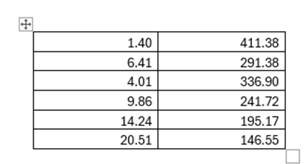

First lets digitize that graph using this open source (available on the internet) program .
That'll allow us to pull actual numbers off the graph without being accused of interpretation error. So that give us the below points we can throw into excel and re-create the curve.
After a little copy/ paste and graphing in excel, we get this, and we can extrapolate values for 5.3 and 6.2 L from it pretty accurately.
Y axis value of 5.3L = 311
Y axis value of 6.2L = 294
For delta of 17
But those numbers are in gm/KW-hr,,,,so lets do some unit conversions over to freedom units.
Each gallon of gasoline has 3217 grams, so that comes out to 0.0052 gals/ kw-hr
128oz/ gal so, 0.67oz/ kw -hr,,,, but who likes talking in terms of KW, so with 1.341 hp /KW that comes out to a whopping 0.504 oz/ hp-hr.
A tablespoon contains 0.5oz ,,,, so a tablespoon is the BSFC delta between 5.3 and 6.2L in hp-hr.
So lets take this a step further because hp-hr is kind of a strange term that's not really relatable.
Lets say driving down the road at 70 mph it takes 200 hp to keep the car moving (which is within the realm of reason for these heavy bricks) and you do that for one hour. So that means the delta in fuel usage for that hour is 100oz (0.5oz * 200hp for one hour). So in that hour/ 70 miles you used an additional .78 gallons of fuel, so your fuel consumption went up by 0.011 mpg. Better get Greta on the phone, you've fixed all the worlds issues.
Considering the fuel consumption of these engines in general, I'm calling that the same.
So again, burn the same amount of fuel (at the same afr) in two engines with the same efficiencies , get the same amount of power.

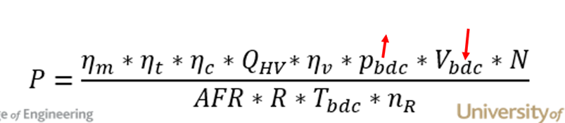

Pressureangle
Aug 6, 2024
60
53
if all other things are equal, then according to the power equation referenced, there is not a mathematical path to same power with a displacement difference between 5.3 and 6.2, if the afr is the same.
If other variables are opened up for change, then the 5.3 absolutely can make same power at same afr. The same power equation says so.
The part you missed is that in this scenario neither engine is operating at WOT and minimum manifold vacuum. The only difference between the two at the same AF ratio and RPM is the manifold vacuum and mean cylinder pressure.
You do realize that if you put the same quantity of air in two different volume cylinders, the pressures will be different right?
For a given set amount of air ,,,, say that amount of air needed to perfectly burn a given amount of fuel at stoichiometric ratio, if you put that amount of air in a smaller engine then;
But if you take that same amount of air (the amount needed to burn a given amount of fuel at stochiometric), and put it in a larger engine, then you get;
Maybe I should have mentioned this earlier, but I just kinda assumed this was a common sense thing.
So burning the same amount of fuel, at the same afr (which requires the same amount of air) in two different displacements engines makes the same power ( assuming the engine efficiencies are the same of course).
That lecture you keep referring to even alludes to that later on when talking about ways to raise power, see Pressure (adding boost) at BDC statement below.
I think that maybe you've not be seeing the forest for the trees and focusing on just the equation as symbols, and not what the equation is actually doing/ telling you. Which happens even in the adult / professional world every now and then.
