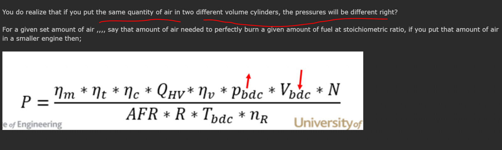

The pressure at BDC is a result how every many cubic feet of air you have trapped in a given size cylinder.
How that air got there, via what size throttle body, or intake valve , naturally aspirated or forced, is irrelevant to the the pressure it'll create once its in there.
Simply put, if you add "X" amount of cubic feet off air in a set volume, you'll get "Y" amount of pressure every time. Increase that volume, the pressure will go down for that same cubic feet of air (and the reverse is also true).
And to burn a given amount of fuel at the same ratio, you need the same cubic feet of air, not the same pressure, the same volume/ the same cubic feet.

Bolded part isn't true here is why:
The pressure starts at a maximum of atmospheric and decreases from there.
At WOT you might get back to 90% VE. (Racing applications can get above 100% VE.) This is from acoustic tuning. You are tuning the pressure pulsations to coincide with the desired crank angle or crank position.
The pressure at BDC is highly dependent on pressure drops along the flow path. This is true for any system flowing a gas or liquid.
If you have a pipe of a gas with a pressure drop across it due to a valve, pressure on one side will be higher than the other side and this drop is dependent on the flow characteristics of the valve.
The air flow into an engine is no different.

Did you intentionally miss the part that says " Once its in there"? or are you just blindly leaving that part out on purpose?
Yes all those factors you mentioned affect how much air may get in the cylinder, but once you trap an given volume/ cubic feet of air, how that air got there makes no difference on the pressure it'll create once trapped.
This isn't a hard concept to grasp, there is even a real simple equation for it;
Pressure at point one (P1) times(x) volume at point 1 (V1) = Pressure at point 2 (P2) times (x) volume at point 2 (P2) or shorthand of P1 * V1 = P2 * V2.
Please tell me you've heard of this very basic equation before, its like high school, maybe even middle school, level.
And what does this basic equation tell you if you trap the same amount of air in two different size cylinders?
And most (if not all) automotive engineers use psia when referring to air pressure in naturally aspirated engines, makes the calculations easier when you don't have to cross zero all the time or use negative values. There is even a sensor called the MAP sensor, why don't you goggle up what the letters M.A.P. stand for in that sensor real quick. Maybe then you'll understand how easy calculations can be even when using pressure below atmospheric.
The induction system will change the quantity of air in cylinder. There is pressure drop and flow restriction.
Saying it is the same isn't correct.
Post 171 covers this as well.

When the throttle is actuated it is changing the effective flow coefficient through the entire induction system. It is the main limiting pressure drop, but not all of it.
Again there is pressure restriction from the intake box, throttle, intake manifold, intake runner, and intake valve.
The mass of air will be different, the volume will be different, and the volume inside the cylinder will be different.
Flow through orifice more accurately models flow through throttle body at part throttle. Flow through venturi would be more accurate model for flow at wot.
Your original comment about an "ideal quantity" (mass or volume...you didn't specify) of air raising pressure in a 5.3 cylinder vs dropping pressure in 6.2, that would/could impact the power equation, is not an accurate or reasonable description of what is going on.
1) if mass is same. Boyle is constant mass. The mass flow rate is determined by the throttle, not conditions at bottom dead center. This is bernoulli, not gas laws.
Alternatively, if you are saying V1 is 5.3 and V2 is 6.2 then the error is even more severe.
If I take 5.3 L at a specified pressure , it will also have a specific mass.
Then if I put this into a 6.2 L container, the pressure will decrease by Boyle’s law.
All this does is prove Boyle’s law, it doesn’t prove your original point about pressure at BDC being higher in 5.3.
In fact all this does, in the inverse, is prove how forced induction works.
If you cram 6.2L into 5.3, you make more power than the 5.3 would at atmospheric conditions.
The reason why this exercise is not applicable is because the mass flow is different between the two engines.
This stems again from how the induction system is configured.
Just think: an 80 mm throttle, 1.9 intake valves, with 5.3L pulling air through them will move less air mass than a 6.2 L engine with 87 mm throttle and 2.16 intake valves.
5.3 has smaller intake runners than 6.2, to go along with this...
2) it takes a given mass of air. Remember you can get stiochiometric balance in any size cylinder, with different masses of fuel and air, which create different levels of power when combusted, at same afr.
