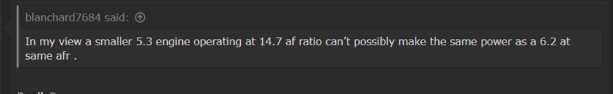

This statement no longer applies, now that O2 sensors force a 14.7 AFR whenever the driver presses down on the go-pedal.
(When lifting off, it COULD go as lean as 15.0 in rare situations,
and if load is high enough, it'll go into Power Enrichment to cool the combustion chamber and keep NOx low.)
With a 10speed, I'd not be surprised if a 6.2L would get equal or better MpGs than a 5.3L, under 70MpH at least.
