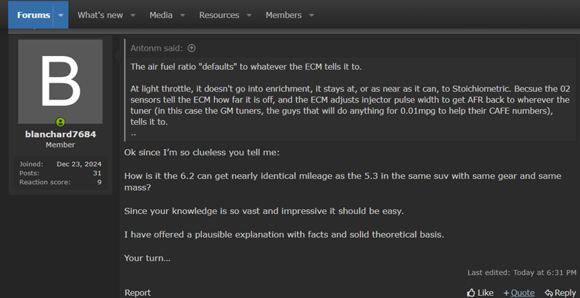

Ok great. Now we are getting somewhere…
Now that we know how o2 sensors create an input signal to the ecm, how does this information apply to the discussion?
My original claim ( worded differently however) was that in some situations the 5.3 will get worse fuel consumption than 6.2 because the 5.3 will need more fuel ( to accelerate the same mass ).
You said this no longer applies because the af ratio is “forced”.
I’m genuinely curious.
If you have tuning experience where this has shown to be the case I’m all about learning.
In my view a smaller 5.3 engine operating at 14.7 af ratio can’t possibly make the same power as a 6.2 at same afr .
Ergo for part load driving the 5.3 will need to be in an afr range that is lower than 14.7. How much? Not sure but if it is any indication my instantaneous mpg reading gets slammed with any touch of the pedal.

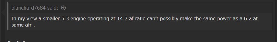

Really?
You don't think a 5.3 towing a trailer up a hill at 80% throttle (with an AFR of 14.7), will be making way more power than a 6.2 at driving on flat ground at 20% throttle (with that same 14.7 AFR)?
But maybe you meant to also include "at the same throttle position", and I'm just pointing out little things.

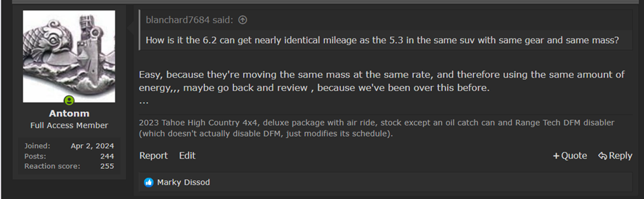

Each cycle , each of the 8 cylinders in a 6.2 is drawing in a larger volume of air and hence a larger mass of air. ( density) .So it can be mixed with a smaller mass of fuel to make the power needed for the above conditions ( relative to 5.3).
Not true, the 6.2 is not always drawing in more air than a 5.3 because there is this little thing called a throttle body at the front of the intake manifold that restricts air.
Physics says to move an "X" amount of mass at a given velocity, it take a "Y" amount of energy to do so.
So assuming the engine efficiencies aren't drastically different between a truck 5.3 and 6.2, then both engines would be using the same quantity of fuel when cruising down the road making similar horsepower at part throttle.
Yeah the 6.2 may be at 20% throttle when the 5.3 needs to be at 30% throttle, but if both are moving the same mass (or accelerating the same mass), at the same speed (or same rate of acceleration), then both would be making the same horsepower at that time and using the same amount of fuel. The only thing that could possibly change this is if the engines efficiencies where different at whatever power level that given velocity (or the given rate of acceleration) happened to be at.

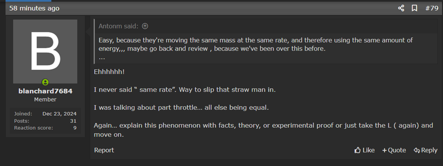

If this is true then why offer higher displacement engines at all? Based on this displacement means nothing.
Same mass, same acceleration, same power to make acceleration happen, ergo same fuel use.
Why not have 1.0 L engines in the suburban, then?
The “ how” in how engines make power matters here.
For the smaller engine, it will have to add incrementally more fuel to mixture to make the same power demand.
Peak power is at 12.8-13.1 afr, not 14.7.
This is based from the adiabatic flame temp curve that is depending on afr.
You can make the same power as a 6.2 with smaller displacement. But the engine has to be operating at higher and higher VE levels and more fuel has to be added ( beyond 14.7 afr) to make the power.
And also for the same throttle position ( depending on throttle body design) the 6.2 will be drawing in more air. 6.2 has 87 mm TB, 5.3 has 80mm. So for the same pressure drop through intake runners, the larger area flows more.
