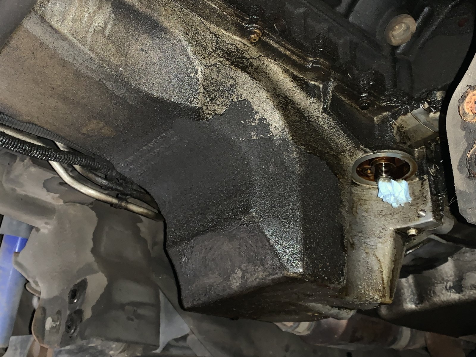

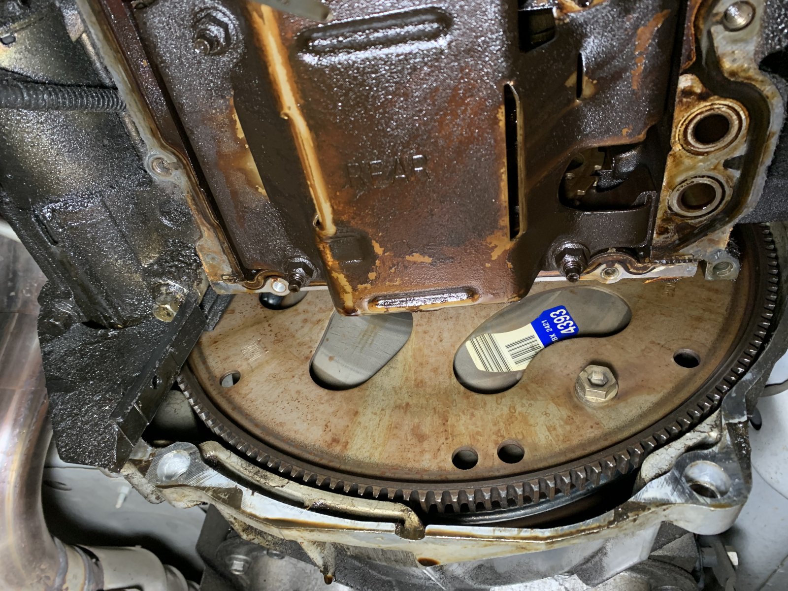

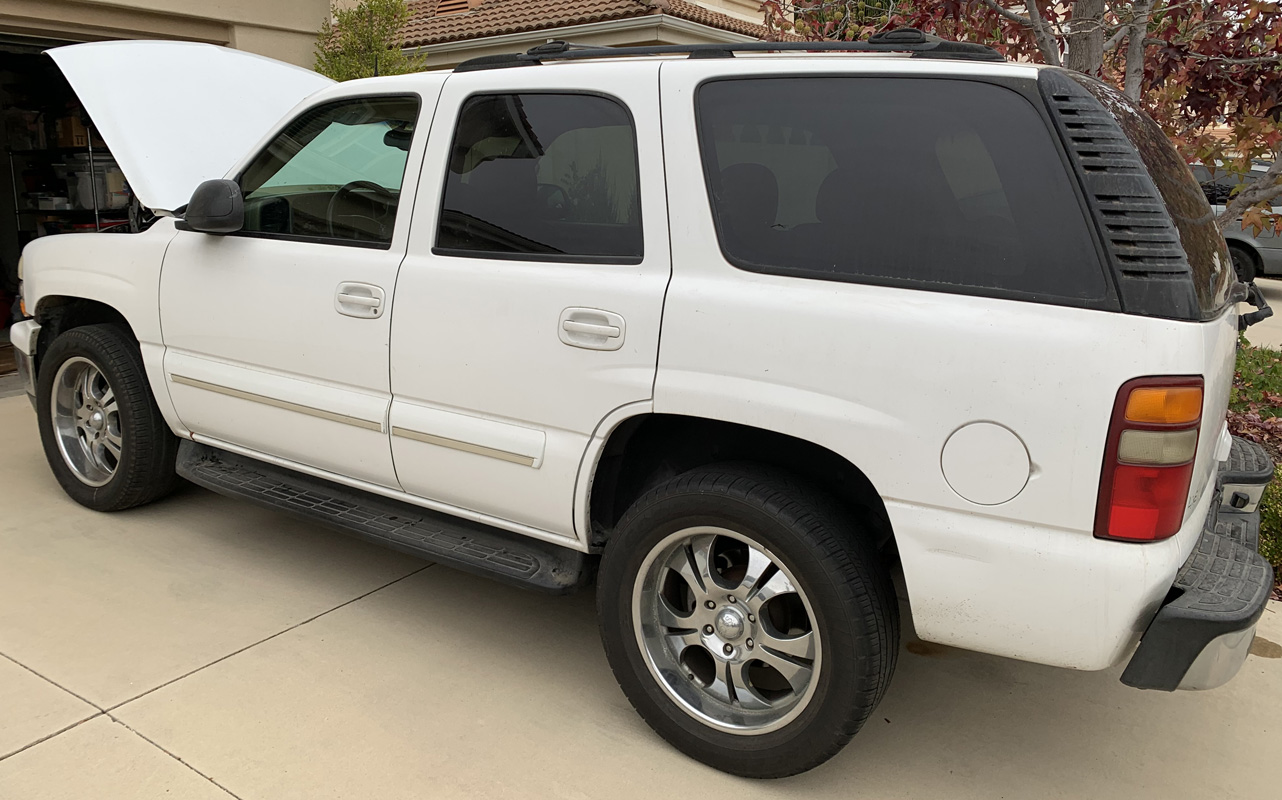

I haven't had much time to do much work on it yet, but started with the oil leaks. The oil pressure was also very high, but I'm thinking that was from a VERY dirty oil filter. I'm going to post some pics of the car starting with the outside, then the engine bay before I started cleaning out the debris, then the oil covered oil pan, followed by a pic with the oil pan off showing the grimy windage tray. I initially though it might have a leak from the rear main, but seeing how clean the fly wheel is, I'm not so sure about that now.
