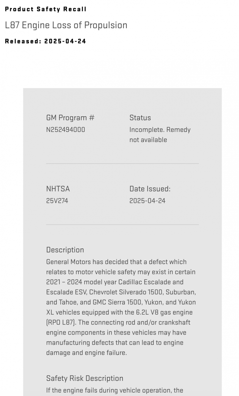

Trying to keep up here. I’m on my 2nd 2023 yukon Denali 6.2L. First one blew the motor at 3600 miles. Did full vehicle replacement. 2nd one has 32k on it and at the (Chevy) dealer right now for oil change. They pulled my codes and I have the loss of propulsion L87 one (see pic) but not the P0016 ppl were referencing. Took a stab at requesting 0w-40 but they wanted to charge close to double so I didn’t throw a fuss. Praying at this point my vehicle doesn’t get marked as condemned and unable to leave the dealer after they swap my oil. Godspeed my fellow 6.2 liters
Your vehicle has clearly been recalled and should have the 0W40 oil. The Service Advisor probably does not know this. The dealer will not likely hold your vehicle unless they see a Pending P0016 code. I have seen few cases of a P0016 code before an engine failure.
The remedy not available means they most likely do not have the 0W40 oil fill cap, but they may.

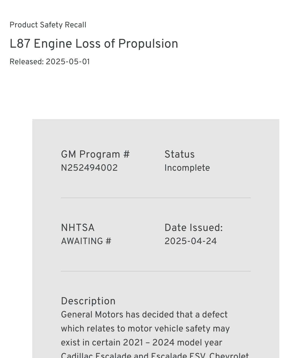

I considered going to an alternate service(external to GM) location and requesting the 0W – 40, or even bringing my own, but I thought that might have an impact on the warranty since they then could not verify that the oil change took place. My opinion was I’ve been running it for 32,000 miles with 0W – 20 and we haven’t died yet. So what’s another few thousand miles. More or less just waiting to see how this all unfolds with the recall. I need my car. I hope that GM is setting up a fleet of loaner vehicles. I wouldn’t mind testing out one of those Silverado EV‘s to be honest.GM.. if you’re listening ..

Fresh 0W20 would be better than oil with 5k+ miles on it. To be honest I have no interest in allowing my OLM to go below 50%.
For the recall, all that is needed is for the dealer to check for a P0016 code, I think remove the oil filter and cut it open to look for metal, then if no code or metal, put OW40 in the engine, install a new oil filter and put an oil cap that has 0W40 printed on it. Pretty simple, but maybe GM has not provided the dealer info on cars that are not in inventory?
