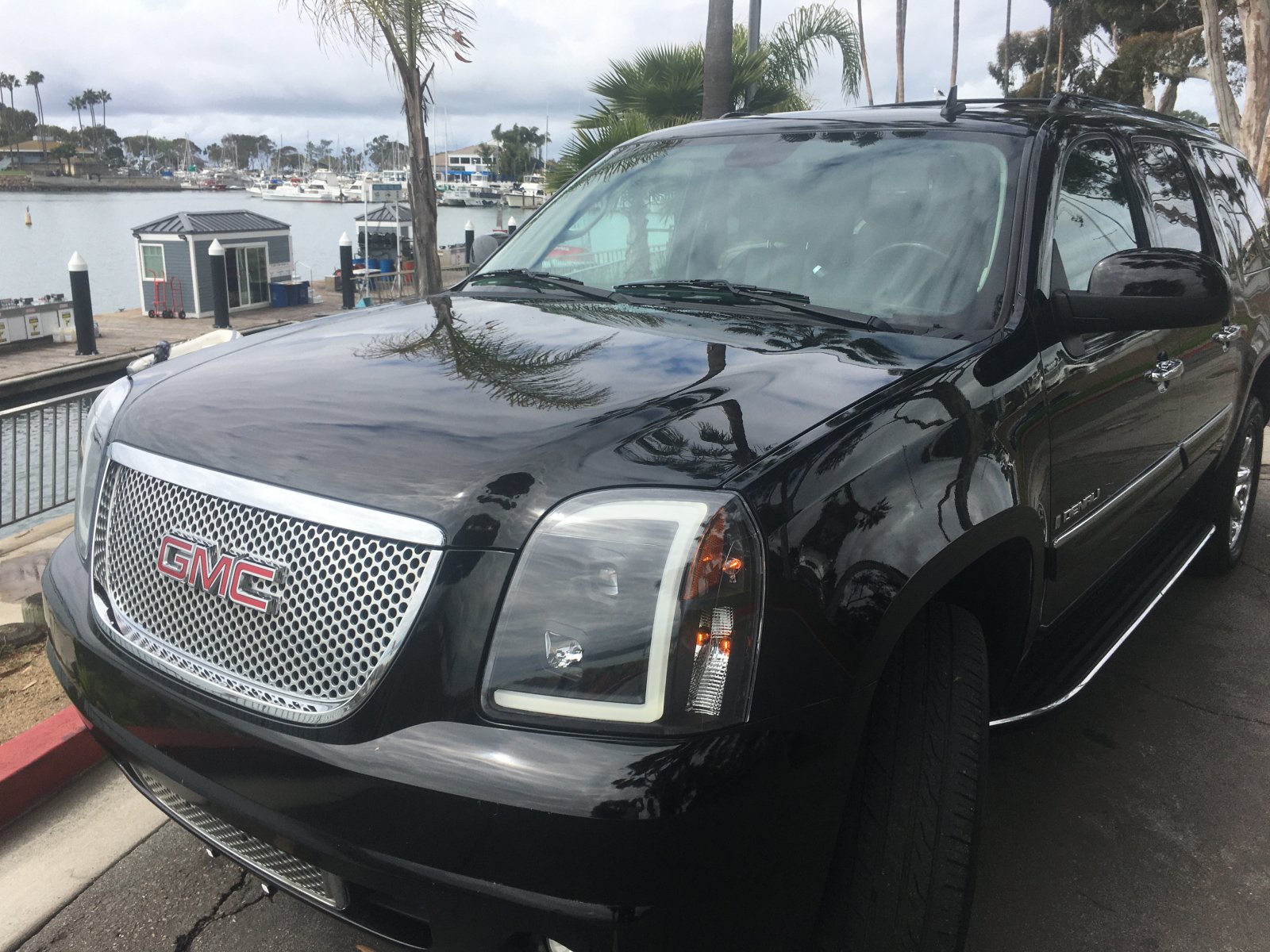

Back in Black. That’s the color to do a respray. I did a 66 Mustang in my teens from yellow to black and removed all the trim. The pop you get after replacing the trim against perfect paint is such an amazing contrast.
The black paint on your Tahoe is amazing. I had our 08 YXL Denali color sanded, polished, respray on the hood and the nose of the roof. Paint was $1.3k and full color sand details and exterior resto was $8h.
Most of the paint was paper thin after the polish but it was flawless all around to the new owner who got the truck detailed to insanity.
