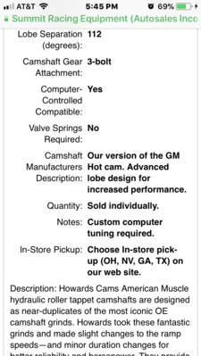

Stock valve springs (12589774) are good for .520 lift. that Howard's Camshaft is .525 and Summit does recommend new springs.
I’m not seeing where you say that Summit recommends a valve spring upgrade for this cam. Are you sure that you are viewing the correct camshaft? In fact for this specific camshaft it says that valve springs are not required. Here’s a picture. Anyone can recommend anything but it’s not required. Hell I’d recommend that we all have twin turbos but it’s not required

Hi Tom, I clicked on the link you provided via my PC. In the Q&A Summit recommends valve springs and Pace Performance's website was where I recorded the max lift of the various springs.
There is a terrible amount of conflicting information out in cyberspace and that being said if yours is holding up well then the combination should be promoted and considered by those looking to do the same. How much horsepower and torque did you gain, assuming you were able to measure the results?
