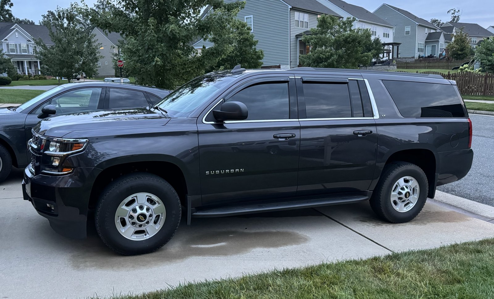

If you are looking for a magic carpet ride, this is not it. We were cross shopping current-gen Yukon XL, Wagoneer L, and Expedition Platinum. This rides like a 3500 pickup, it bounces and jounces over bumps but all in all I’m very pleased with the ride and performance. It got my wife’s stamp of approval and she drives a Lexus so call that a huge win. Otherwise everything inside the truck is Suburban. It’s awesome and 10/10 would recommend.
On a Wed I was on a local dealership site and saw Suburban 3500 in there filter box and thought they made an error, and learned these things exist. Thursday I did a national search on AutoTrader and my LT was listed that day… dealership was an hr away and I knew a few ppl there. Told them I was coming Saturday morning for it. Rest is history. I have not seen any other LT’s come up for sale since.
The truck has a 10k class IV receiver rated at 10k lbs so that is the max for now, but based on everything I have lined up with the 3500 SRW pickup I think this has a max closer to 13-14klbs with correct weight distribution hitch and a class V receiver. Not sure I want to tow that much but I think it’s in the realm of “reality.”
Good luck on your search but we needed the space for dog, kid, and road tripping room. Towing is just a MAJOR bonus, if you are planning for towing heavy kinda regularly, you may want to look for a gas dually?
