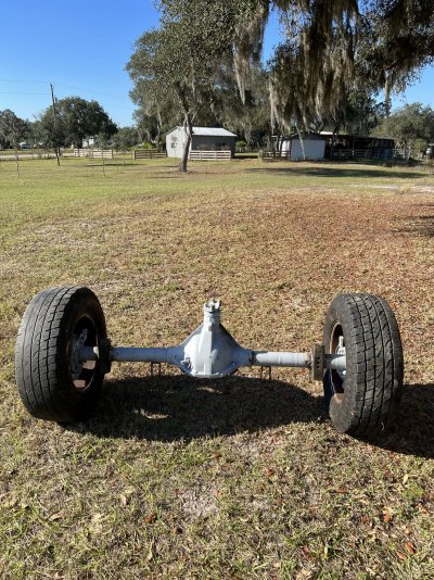

Made a stop by my buddy's shop during work hours and in an incognito work truck to catch him off guard and give him shit for not starting my axle. Well, he surprised me and it will be done this afternoon! Seriously an awesome dude to work with. Can't pick it up until tomorrow unfortunately but I should get some teaser pics tonight.

Didn't get home until way late so I didn't have time to check on anything. Spent a couple hours actually helping lay the powder for my axle. Wasn't allowed to take any pics or videos of the process but it's pretty awesome if you never seen it done. This is a 3 stage powder with very specific heat cycles and cure times, pretty scientific stuff.
Anyway here's some indirect vs direct light differences. I think under the truck it will appear black 99% of the time but if head lights or something hit it then it will look cool.
