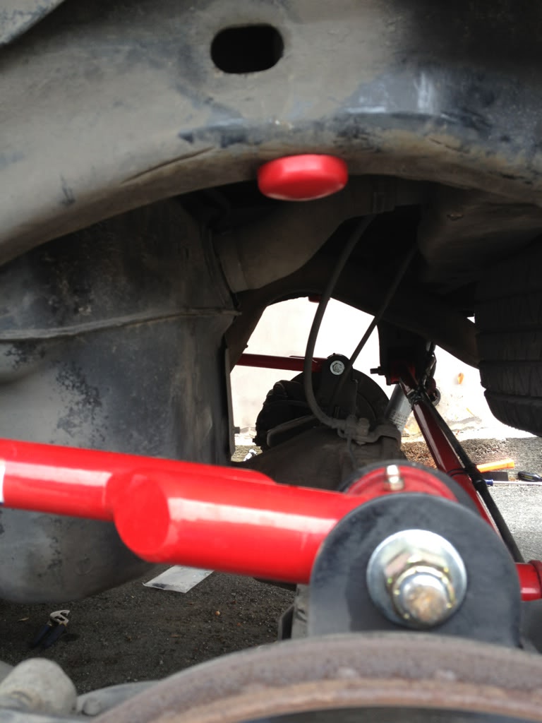

Hey guys, does anyone know how to change the bumpstops in the front? Cuz I need to put new ones in I think because I cut the front bumpstops super short (almost to the cups that hold them) not knowing the theory of how the torsion bars worked and that the bumpstops actually need to always rest on the a-arms. Am I on the right track?
They just pull out, just grab them and yank em out at an angle, can use a screw driver to help get back in. they r held in by 4 indents in the cup. Replace with some Z71 jounce stops. Much better ride IMO-Max got me on them and they ride better anyways.
You are right on using jounce stops. Are torsion bar suspensions are made to use them, acts like a progressive rate spring. I have run with stocks, cut stocks(different heights) no stops at all, Z71 stops, cut Z71 stops, and finally found a height that works for my setup and feel with cut Z71 jounce stops. But the Z71 stops felt the best compared with stocks.

Nice. Well I'm gonna grab me a set of some Z71 bumpstops and slap those bad boys in. Where's the best place to get bumpstops like that from?

So I did some shopping around and found some bumpstops but only place I could find them at wa the Chevrolet dealership. $24each. Is that about what you paid for yours Whiteout?
