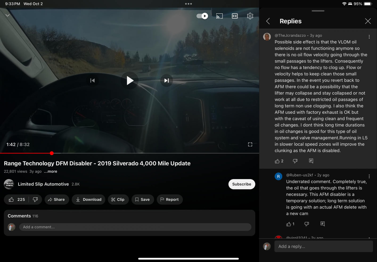

Just a side note on those lifters. Seems to me that keeping the lifters pumped up full time would have to eliminate most of the failures we've seen. When those lifters collapse due to the oil cut off all those little internal parts do take a beating. And I wonder why there are no direct retro fit lifters that work with the AFM original camshaft?
