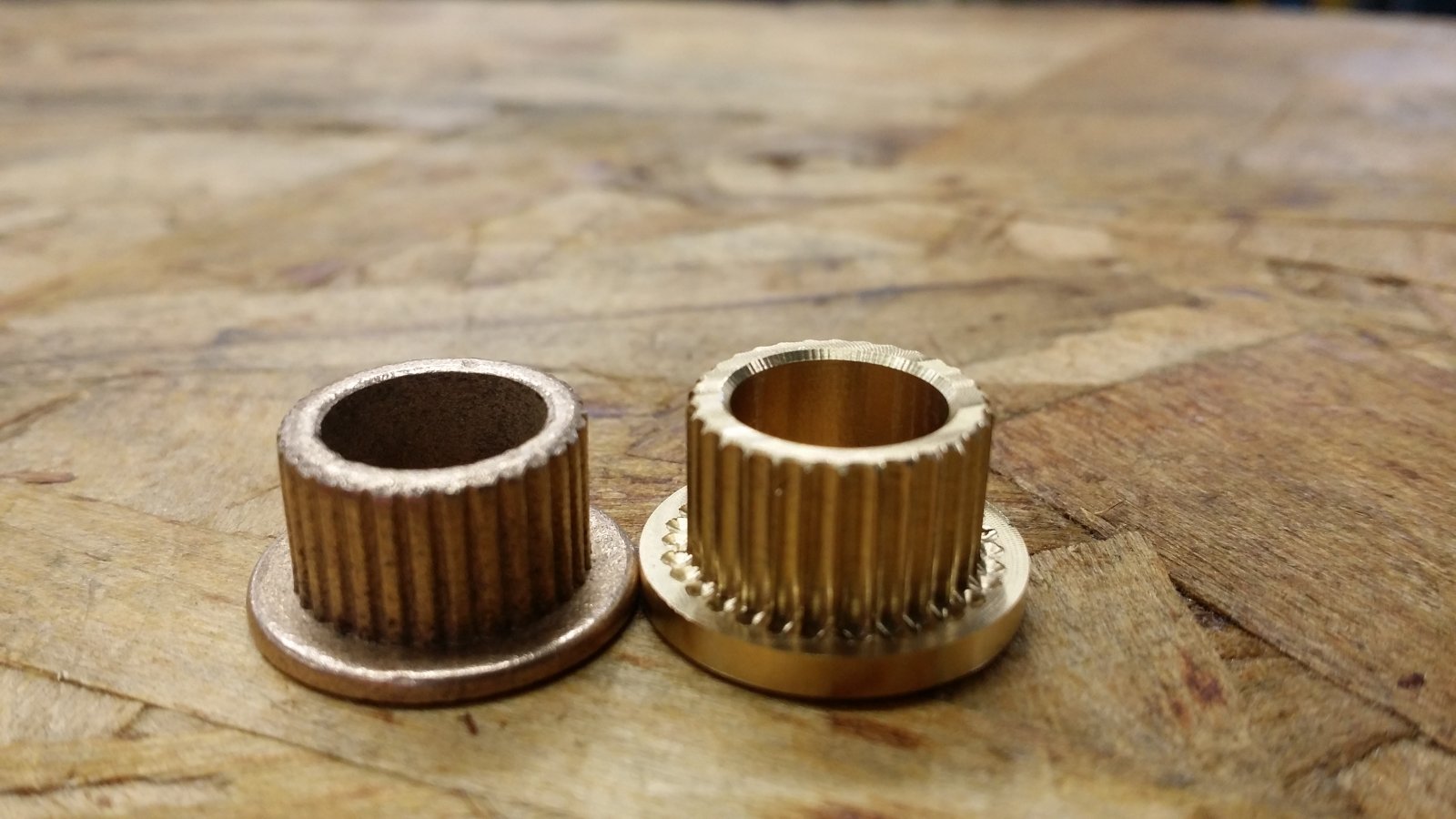

The bushings for the pointed end of the pin are just overaized ones that are crushed a little to be ovalized. Pretty cheesy

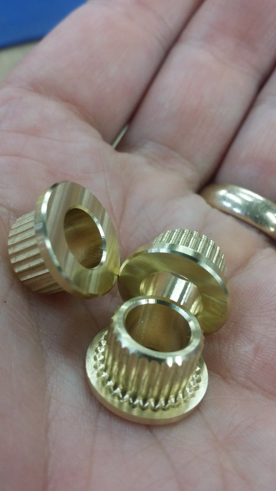

View attachment 220354 View attachment 220352
Don't go too long without replacing them or you may end up with the hinges wallowed out also......:)
I'm gonna guess they are since the bolt that catches the door lock is showing wear and I've shaved about an 1/16 occasion metal off the top corner of the rear driver's door smh.

go the to a real hardware store and look for a sleeve or have some made by a machine shop, there is a few on ebay but you may have to message them for specs
I'm liking that idea. It would be a whole lot easier than the other options.
Come to think of it, somewhere on ebay I saw oversized bushings. Possibly allowing a guy to just drill out the pin holes a little larger and inserting the oversized bushings.
