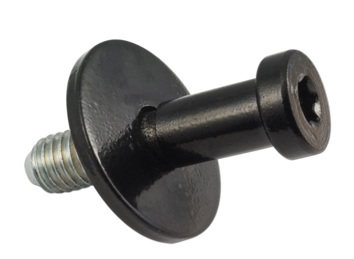

I think i need to replace the striker and latch
Striker will adjust up/down and in/out and that should help but from the weight of the door sagging for so long your body and door frame where the hinges are welded to may have been inadvertently bent from slamming and or lifting up on the door to get it to close.

I need to adjust the striker in then because me door isn't sealing. how do you adjust it?

Star driver, should be able to turn it just like a screw, righty tighty lefty loosey. It will be tight as a mother so i used to use a pair of vice grips to help it along while trying not to mark up the striker. Be sure to mark where it is now, sharpie around it will do, so you have a point of reference.

what about that is adjustable?

Once you loosen it you’ll be able to move it up/down and in/out...Like i said before. Loosen it slightly, its threaded into a nut that slides around between two pieces of sheet metal to give you up/down AND in/out adjustment.

I didn't realize there was a plate on the back that could move. thanks!
