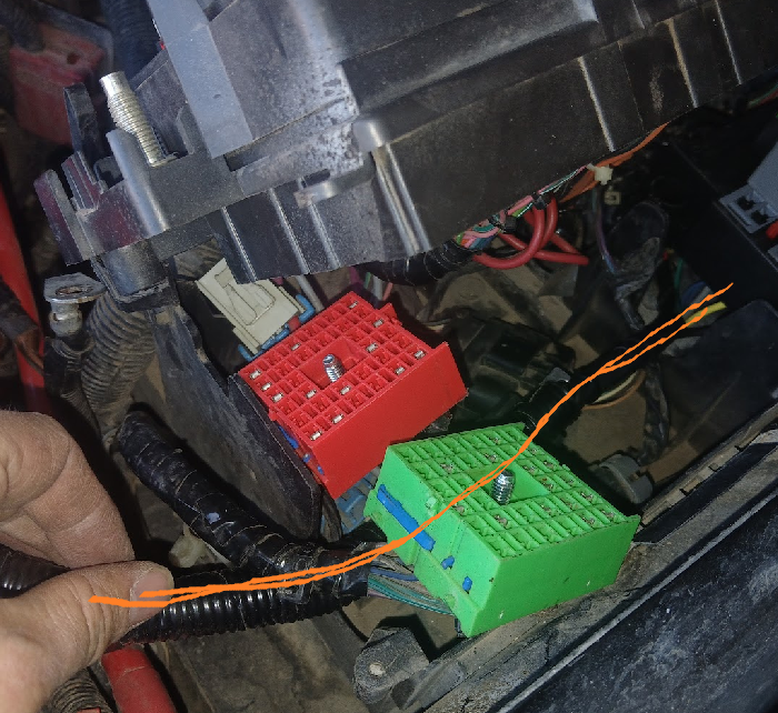

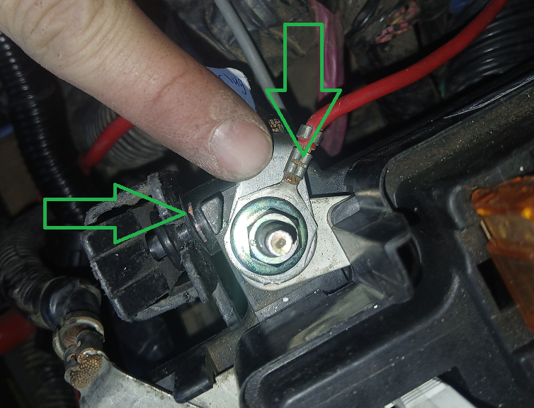

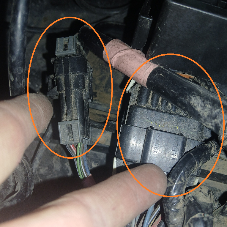

I converted my 04 2500 sub to e-fans. I sourced the fans from junkyard. Pulled the fans and harness from same vehicle. Split the forward lighting harness apart and grabbed the OE complete fan harness with factory fuse/ relay blocks. If the fan motors later go bad, you can source just the motors and blades. No need to buy a complete housing assembly.
Currently I have 2 harness in the sub, the oe for when I get the ecm programmed. Its stubbed out ready to go.
The second harness is out of an 2006 to 2010 Impala police car. It uses external relays and power source **** fuses. I currently have both fans wired through two relays not three. They both are wired for high speed only and through the ac request signal. So technically they will only operate when the the compressor is on. I know its not the correct way, but it works.
