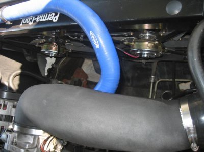

I'm looking for electric fans that when "all said and done installed" look like factory but would like to see any successful install pics as well!!
This is the installed purma cool fan pack
