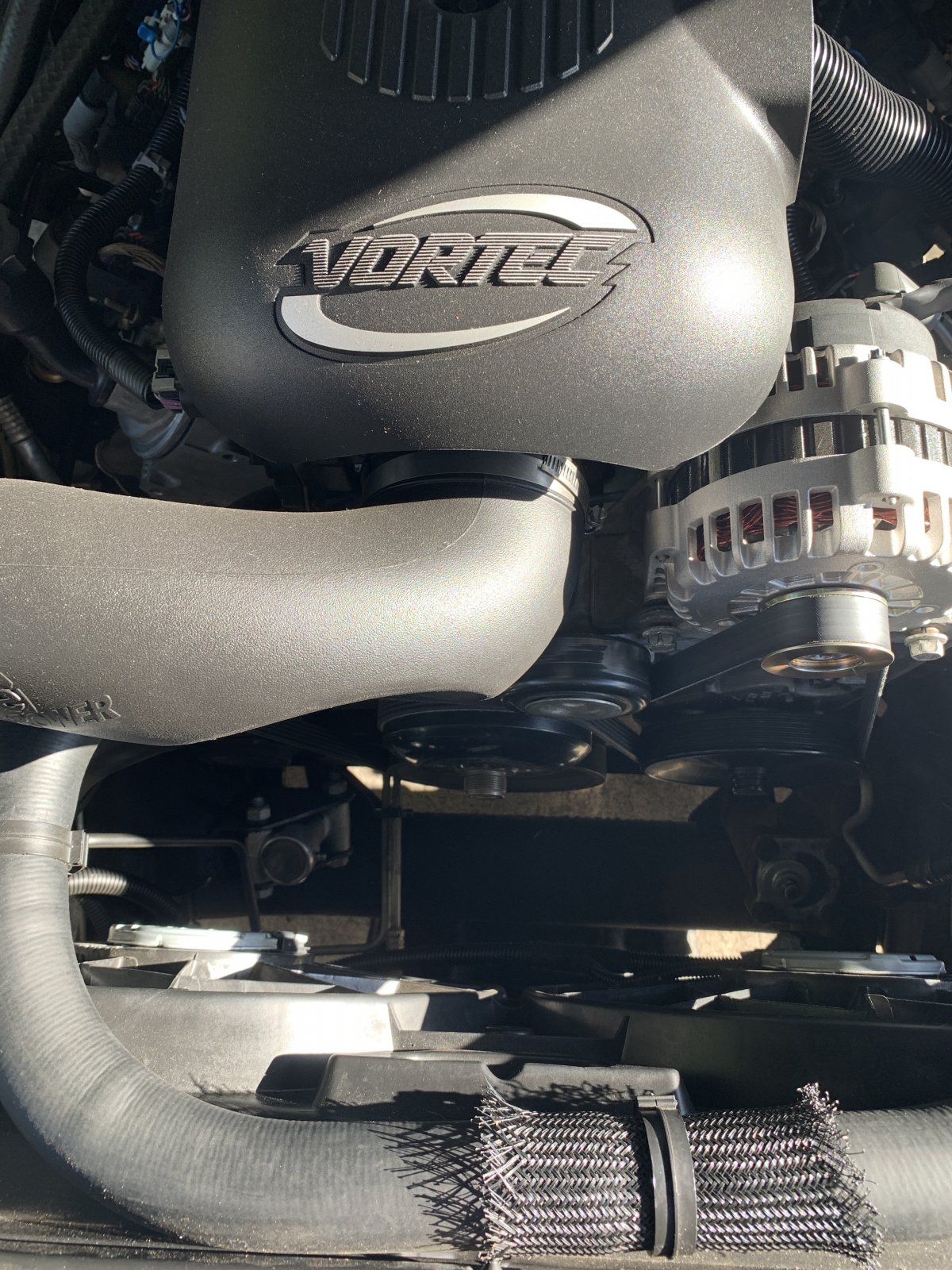

I converted my 2003 2500 Yukon to twin electric fans to try to get additional cooling for our desert conditions, as well as take some load off the engine. However, after several power supply issues I switched back. I would rather run with a bad clutch than risk it all with no cooling fans. A better design would be independent power to each fan. At least blown power would affect only one fan. Too much risk. So when shopping for electric, ask about the power supply design.

Those fan motors look like twin 700 watt? They move massive air! Im running one 500 on the 5 blade and a 700 on the 7 blade. I have the other 700 sitting here and am so tempted to try them both again, The first time i wasnt using an overdrive pulley and at an idle the current draw from the fans going to high glitched my radio. I now run the denso 220 amp alt with 2 inch overdrive and feel it is worth trying again. Your system is proof it works!
