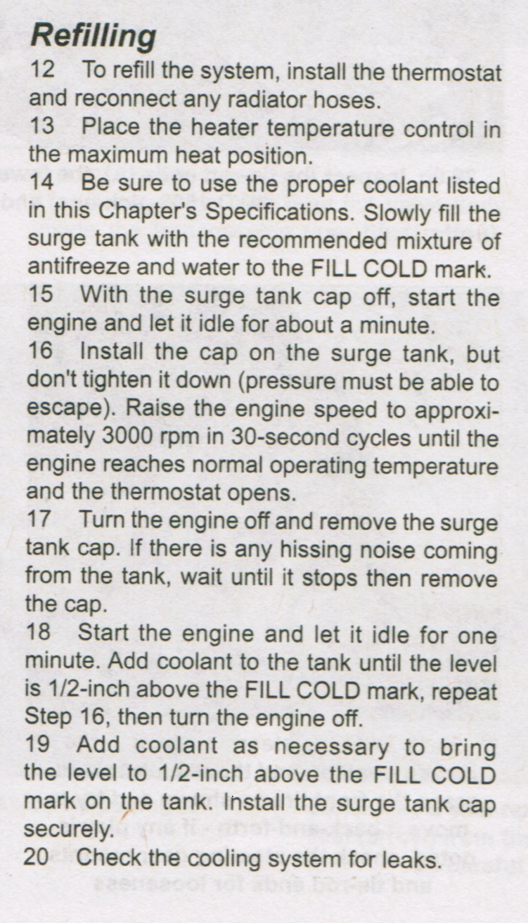

Again, this is why I am flabbergasted at the lack of a better service manual procedure. Everything (other than removing and testing the thermostat) is left to speculation it seems. In other words...they don't give you any explanation as to what the proper operating characteristics are. For example: how should the engine coolant temperature look when given a certain outside temperature? How about coolant temperature vs rpm/ engine load or different driving scenarios?

I am going to take some temp measurement at the hoses and see if the coolant is heating up in the radiator. Guess it won't hurt replacing the thermostat again. I just hate having to drain the coolant as there is no drain plug.
