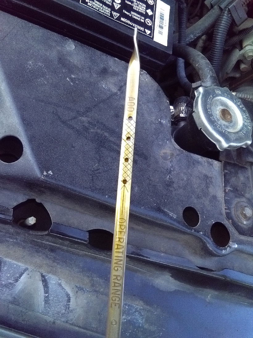

I appreciate all the great advice folks! Manual says 5qt. Reading slightly lower on back side of dipstick (about at O instead of R in "OPERATING RANGE"). Dipstick wasn't perfectly horizontal when I took pic. Reading probably a little high. It's a good 1/2-3/4" past top hole in any case. Street its parked on not perfectly level but not that far off.
Dipstick smells like oil to me with no obvious fuel odor.
Shop's half hour away and driving back sounds risky. Tried to crack drain plug to let a little out but way too tight. Afraid I'll break ratchet, plug, or shoulder if I keep at it. Setup here no good for wrenching anyway. Ordered a big syringe so I can try pulling some out from dipstick tube. Guess I'm not driving anywhere for a few days.

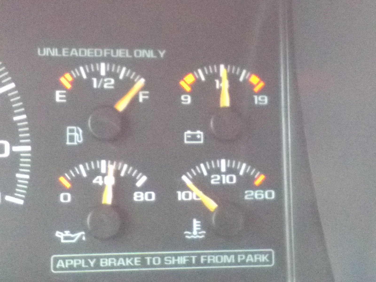

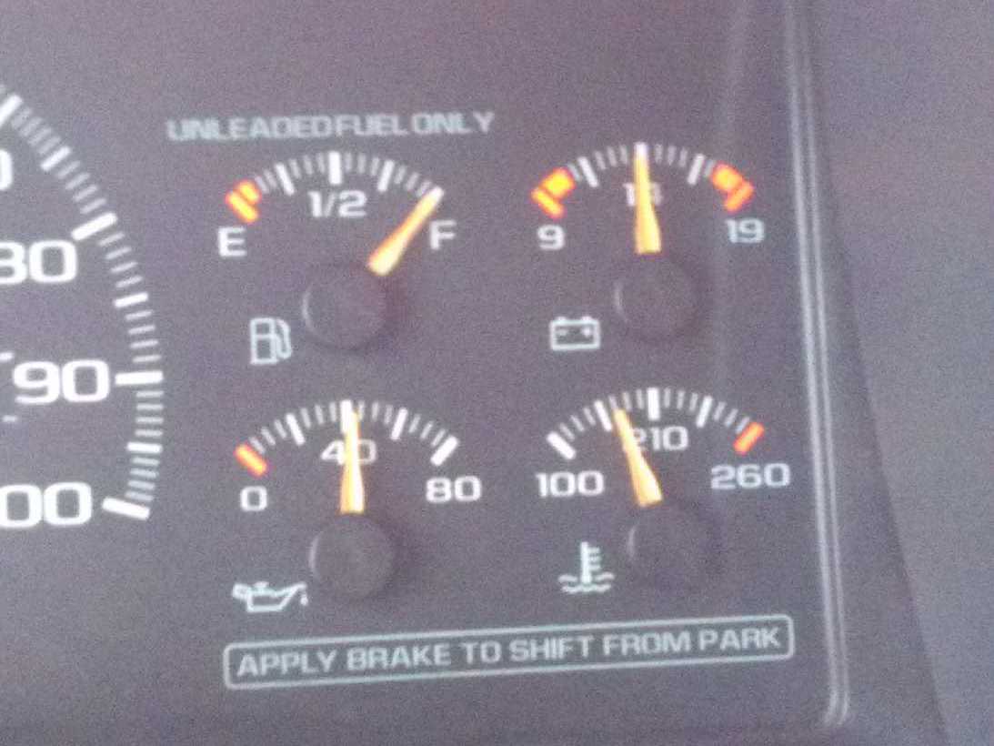

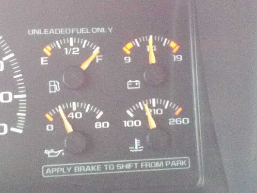

Thanks again. Seem like easy fix. I just hope no damage is done. Do the pressure readings sound weird?

What were your pressure readings before the oil change? Every vehicle can be a little different. Even different oil filters or a defective bypass valve can give different readings.

Put the truck on level ground and let it sit allowing the oil to drain back to the pan if it's been run. Wipe the stick clean and take a reading. Look carefully at both sides of the stick. Many times the stick will rub the tube and smear oil making it read wrong.

Honestly never paid much attention to pressure readings before. I know they were always in range. Otherwise I'd have noticed. Best I can recall maybe 20-25psi (about 10 or 11 o'clock) was normal. Can't remember if it went higher while warming up or not.
