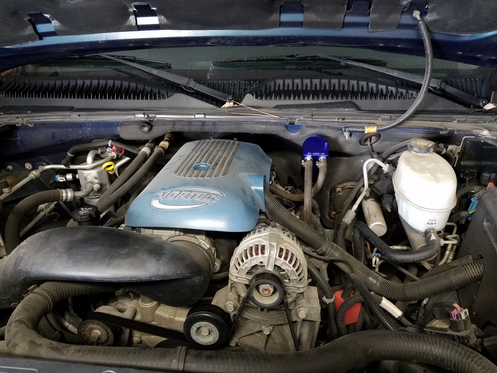

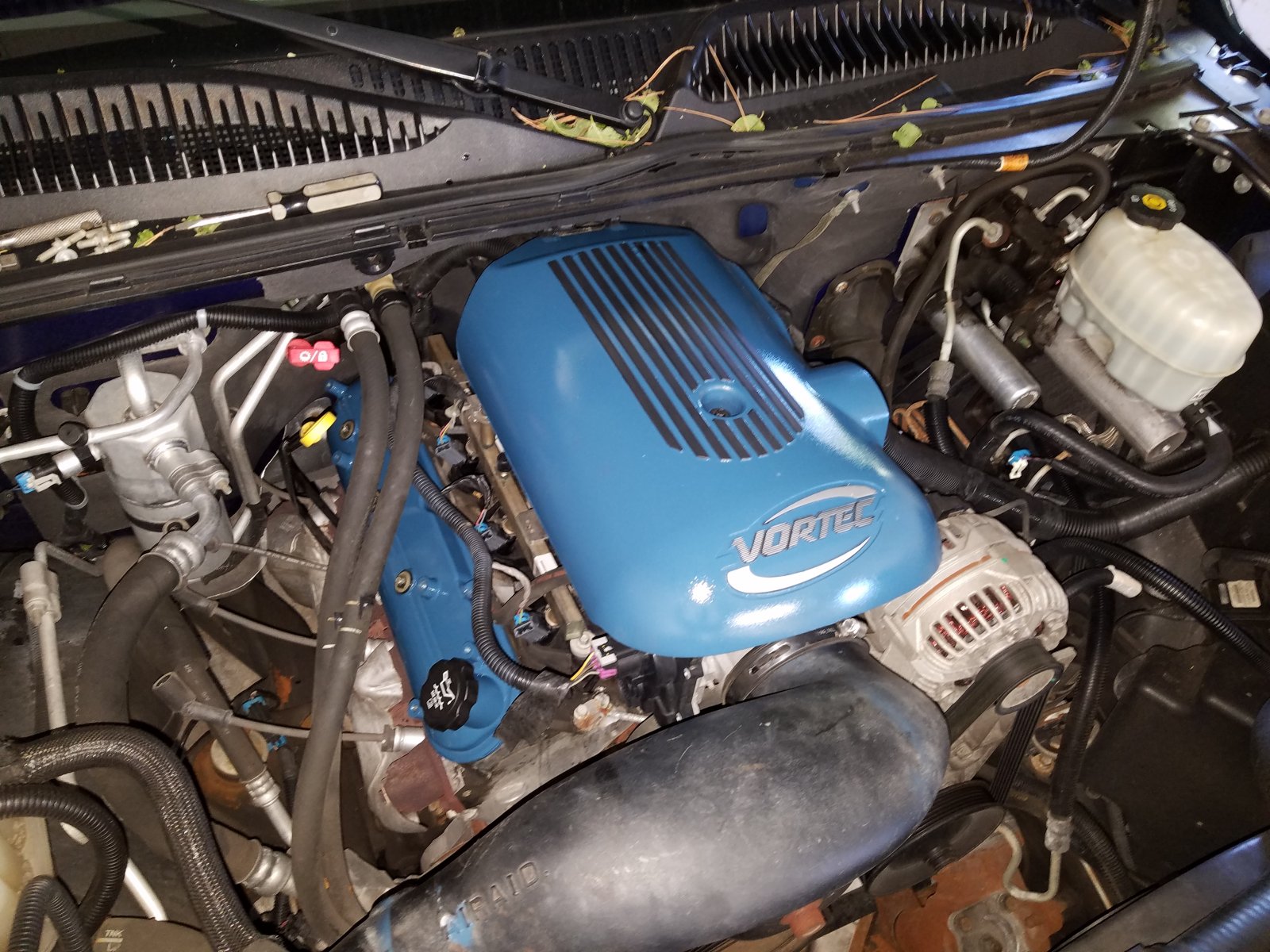

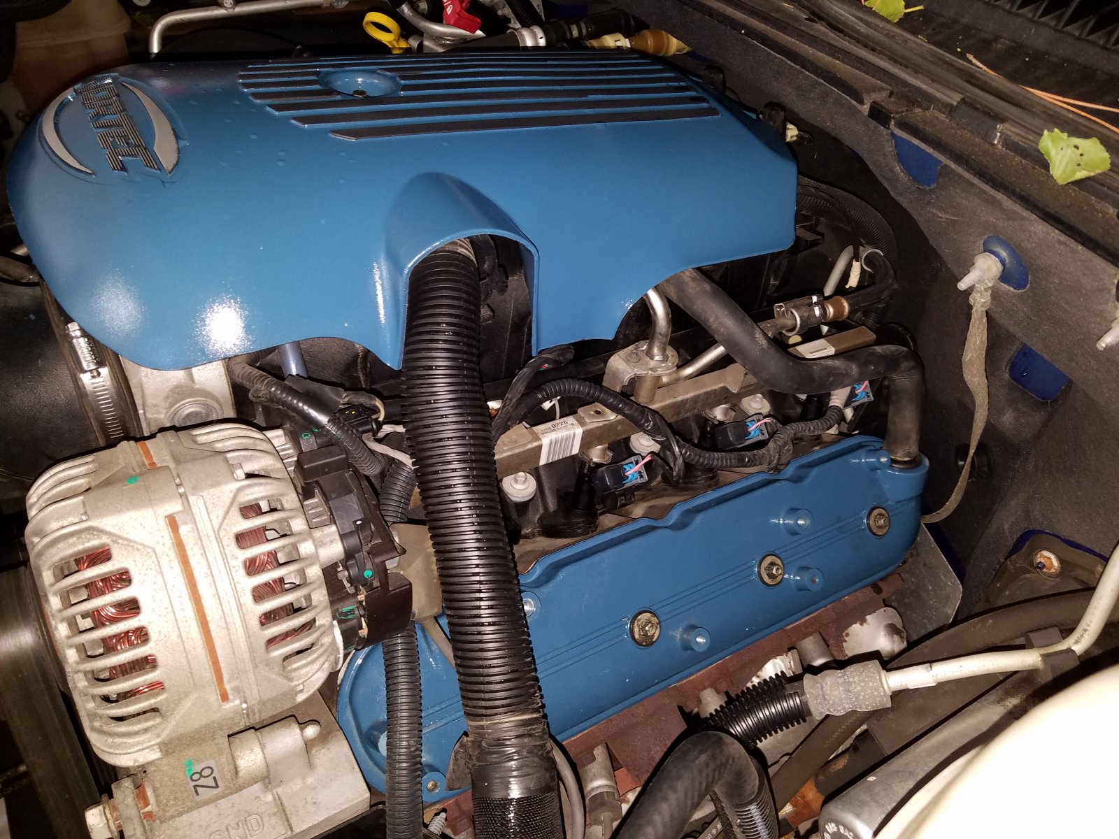

Let's see some pics or description of gussy'd up engine compartments. I regret not painting the block now, but what's done is done. However, I've been considering spraying some paint color on the accessory bracket after seeing how much better a fresh coat of black paint on the balancer looks.....nevertheless, seeing the balancer once installed is fleeting. If you spent some time with paint or other details in the engine compartment, let's see. I'm all eyes on suggestions. Thanks again.
