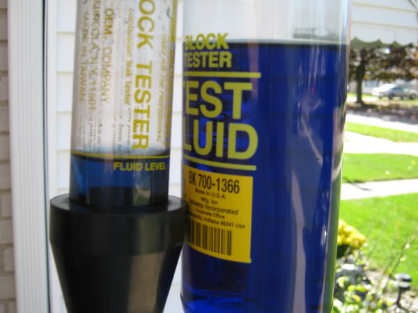

Fluid was really low. Appreciate it bud. They said they wanted to test the fluid. That sound right? I don't know much about motors

Testing the fluid is likely same as I suggested. If you are losing coolant and none on ground then could be head gaskets but get the test first. maybe you didn't get the air pocket out of it when refilled after rad replacement. Let us know what the test reveals. Do not accept "has bad/blown head gasket", you want to know and report what tests he/she did and the results.

they might have meant that they would put a device on the rad opening that would indicate if it saw combustion gases in the cooling system.
