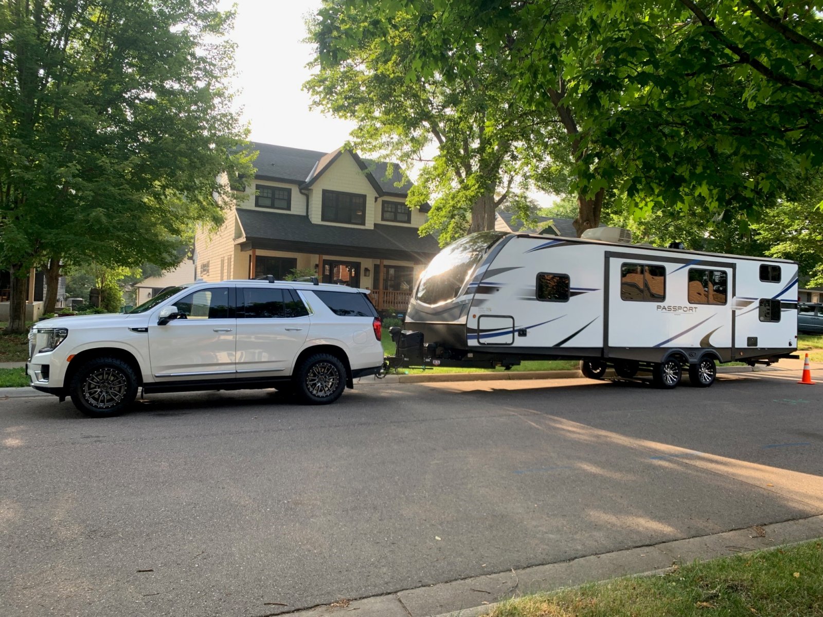

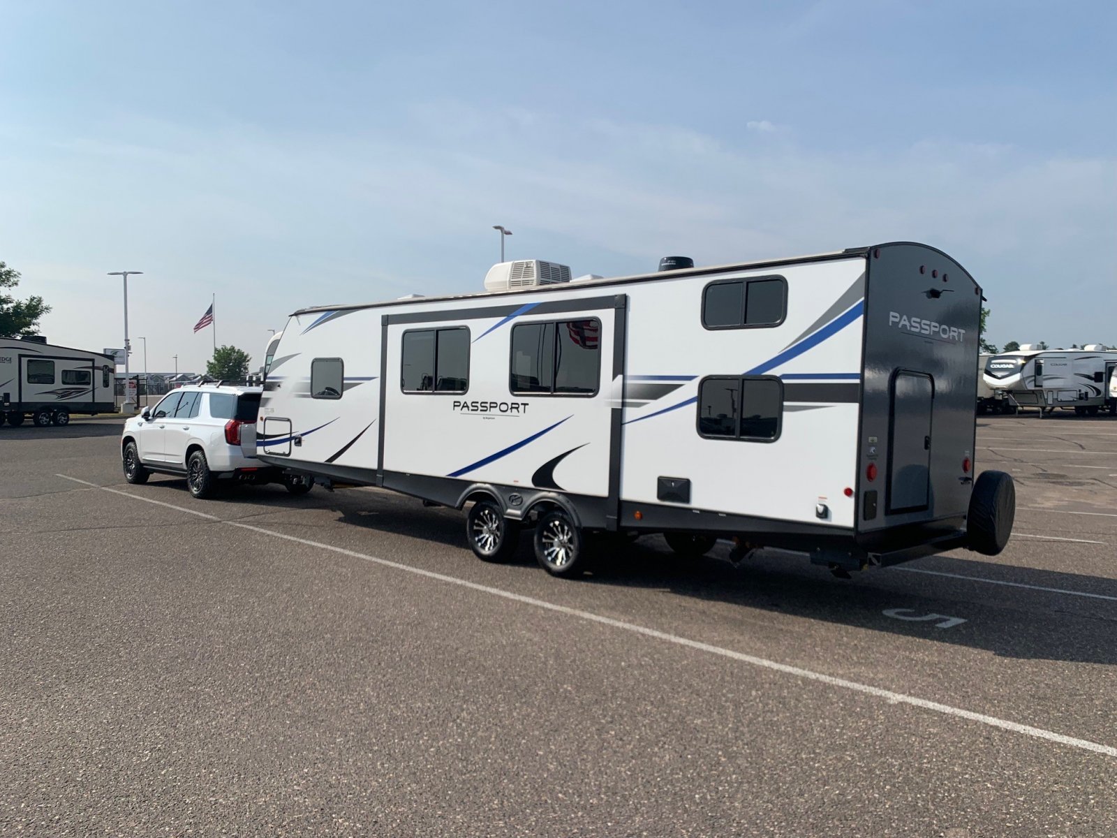

The 6.2 is plenty good enough to tow that. I towed our 8000 tt with the wifes yukon/5.3 and it handled it just fine (kind of amazed me actually).
As far as air suspension goes…yes it can be troublesome.. but also phenomenal when working properly. With this new platform, there is currently no aftermarket support for air assist, and that has clearly been an issue with many people when reading over the forum. These rigs sit pretty damn level oem, so unless the wd hitch is setup perfectly and is actually “enough” to get everything leveled back up, you should expect the saggin-ass look when towing heavy.
