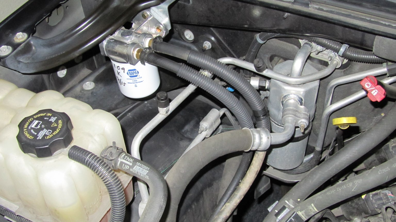

so what transmission cooling line coming out of the radiator did you splice into? The top or the bottom? I think the bottom feeds into the rad and the top one returns to the external cooler then goes back to the trans correct? did you cut the line?

Upper line is the pressure line out of trans...lower line should be return into trans.
I used the top one. I'm not really sure it matters. Either way, the ATF if filtered before it returns to the transmission.
