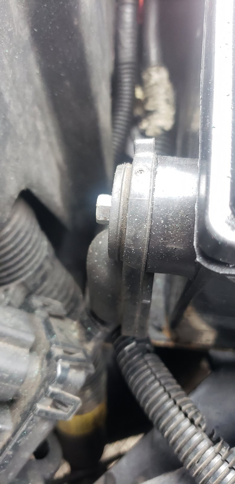

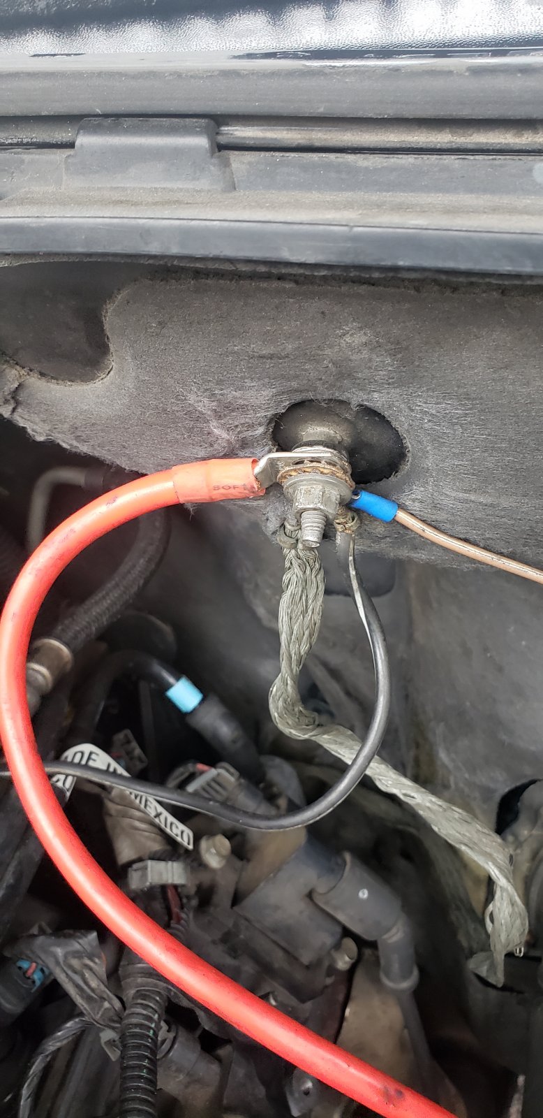

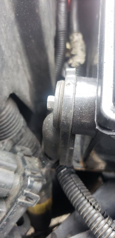

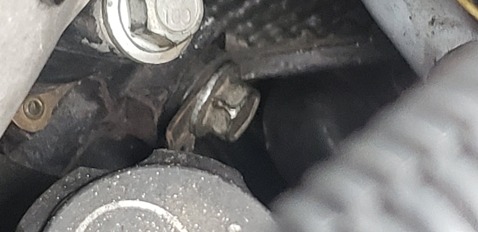

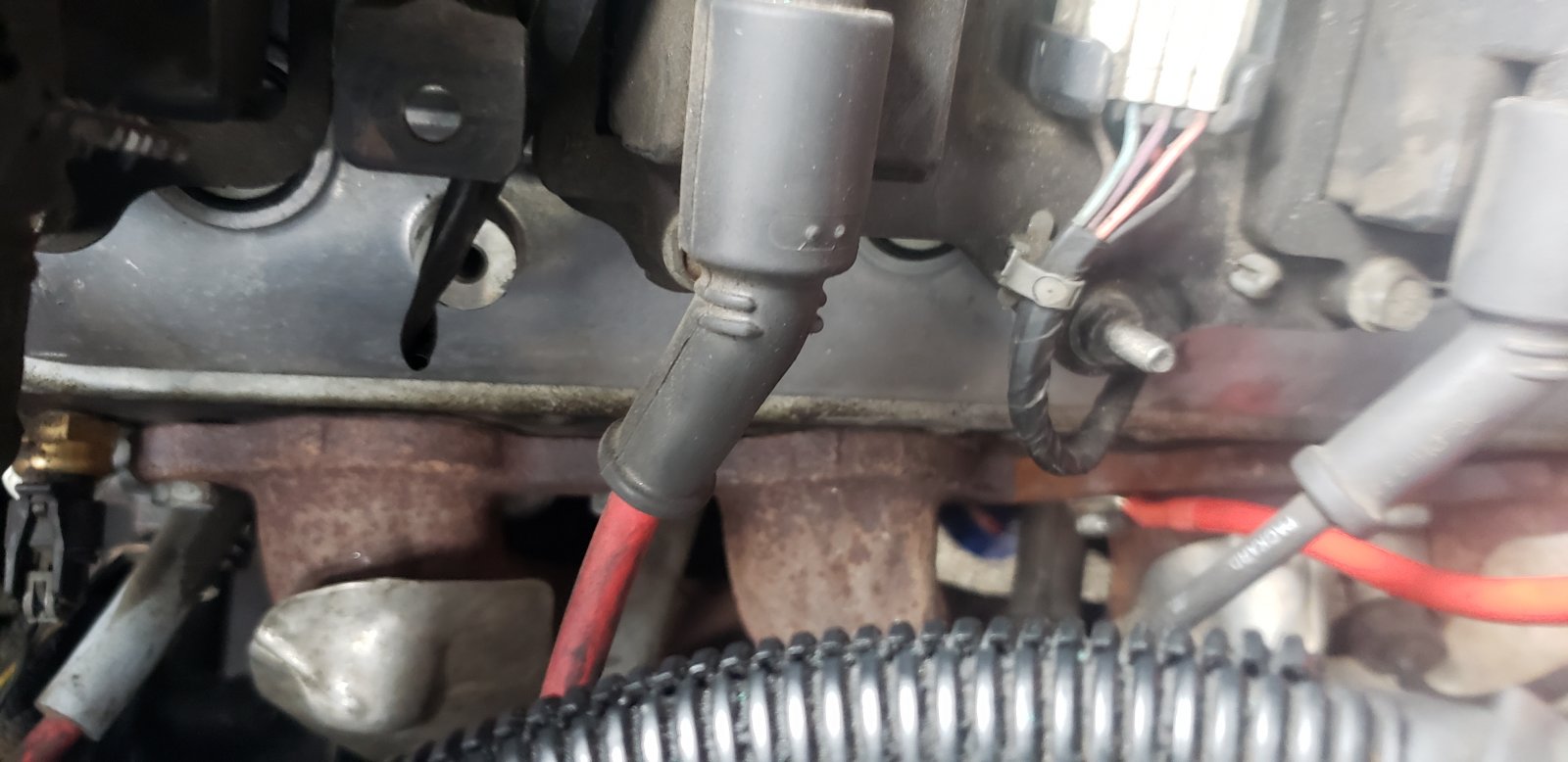

SOLVED!!!!! I had the same issues. I changed that starter and battery and it still started slow and the clock would reset to 12:00. I then cleaned the braided ground from the firewall to the engine block. The small ground that runs from the battery terminal to the front bumper underneath. Cleaned the battery terminals with sandpaper and replaced the terminal volts. I also added another ground from the firewall terminal to a stud on the exhaust manifold. I connected the battery and got in the truck and noticed the clock said 12:04. I started the truck and it started smooth and quick with no drag. I shut it off and restarted it and the clock kept its time and starts great. I did notice the ground terminal bolt was stripped out inside the battery.
Get rid of the ground that you to the exhasut manifold to firewall! Contrary to popular belief, adding extra grounds does not help. It can actually cause problems. Now if you want to take the firewall to engine block ground and replace it with a large wire or even 2 wires then that is fine but if your vehicle needed an extra ground from the firewall to the manifold then GM would've put it there.
