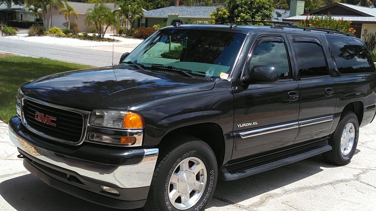

I'll vote for GMT 800, but I'm partial to them. I have a 1999 Silverado RCSB 2wd that bought back in college. Got really good use of it. I bought an 06 Suburban 2500 2wd because I needed more room to drop my kids off school in the morning but hanging on to the 99. The suburban is pretty high mileage, but runs good. I also have an 04 suburban 4x4 that I bought as a project. In the GMT 800 to me it boils down to 4L60e vs 4L80e. I really like the 4L80e. Even learned how to overhaul them myself last year. I just wish the 6 speeds were more durable. I mean, many are. And rebuild kits are so darn expensive. I have a 6 speed in a 2020 Express Van my wife drives.
Interestingly, my 99 Silverado has rack and pinion. I just replaced it because it was leaking badly, and basically rebuilt the entire front end. On it's third time rack and pinion at 270k. The 06 is steering box. I've never understood why some trucks have R&P vs steering box. I thought on the 99-02 1500 trucks it was a 2wd vs 4x4 thing?
I didn't realize the GMT 900s had R&P. That's on all of them? Even the 4x4? I don't think I've been inside a GMT 900 now that think about it.
