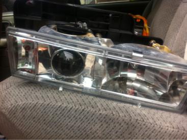

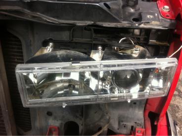

Ok guys update for the day. My guy came by today he and I got got all the housing issues and fittings fixed. We used a relay adapter for the HID's and Ballasts. Now here is my only issue. I need to ground the pos and neg wire to the battery and get it bolted in their. Problem is the ring washers at the end of the Relay adapter that are supposed to go onto the battery are to small. Is there an adapter for that? When I put them up against the battery terminals the new HID's light up perfect. Any idea what I should ask for when I call Oreilly's?

Dist Box? where the Fuse Relay box is near the spare battery area? Sorry So new to the Chevy world.

I read that I could ground the Black wire to the vehicle frame if need be.

left side of engine compartment just forward of firewall. remove cover and look on the side of block.

Thanks I am heading outside now to see if that will work. Is their a specific spot to ground the red and black too? I have been trying to find video installs to no avail. Still got a few hours of light out though otherwise gonna be driving with the brights on lol.

You do not ground the red you attached it to one of this posts. The black can be grounds on existing ground in the compartment just look around for black wires bolted to the sheet metal or brackets.

Ok got it thanks! I just need to run and get a bolt and washer to bolt it to there.. I am attaching to the side not the top two parts since the relay part is still to small but the side connector will work and is big enough.

Ok guys got it all wired up thanks for the help! 35w bulbs feel a bit weak. The PIAA bulbs that were in before were 55w so I wonder if I can toss 55w in next week.
