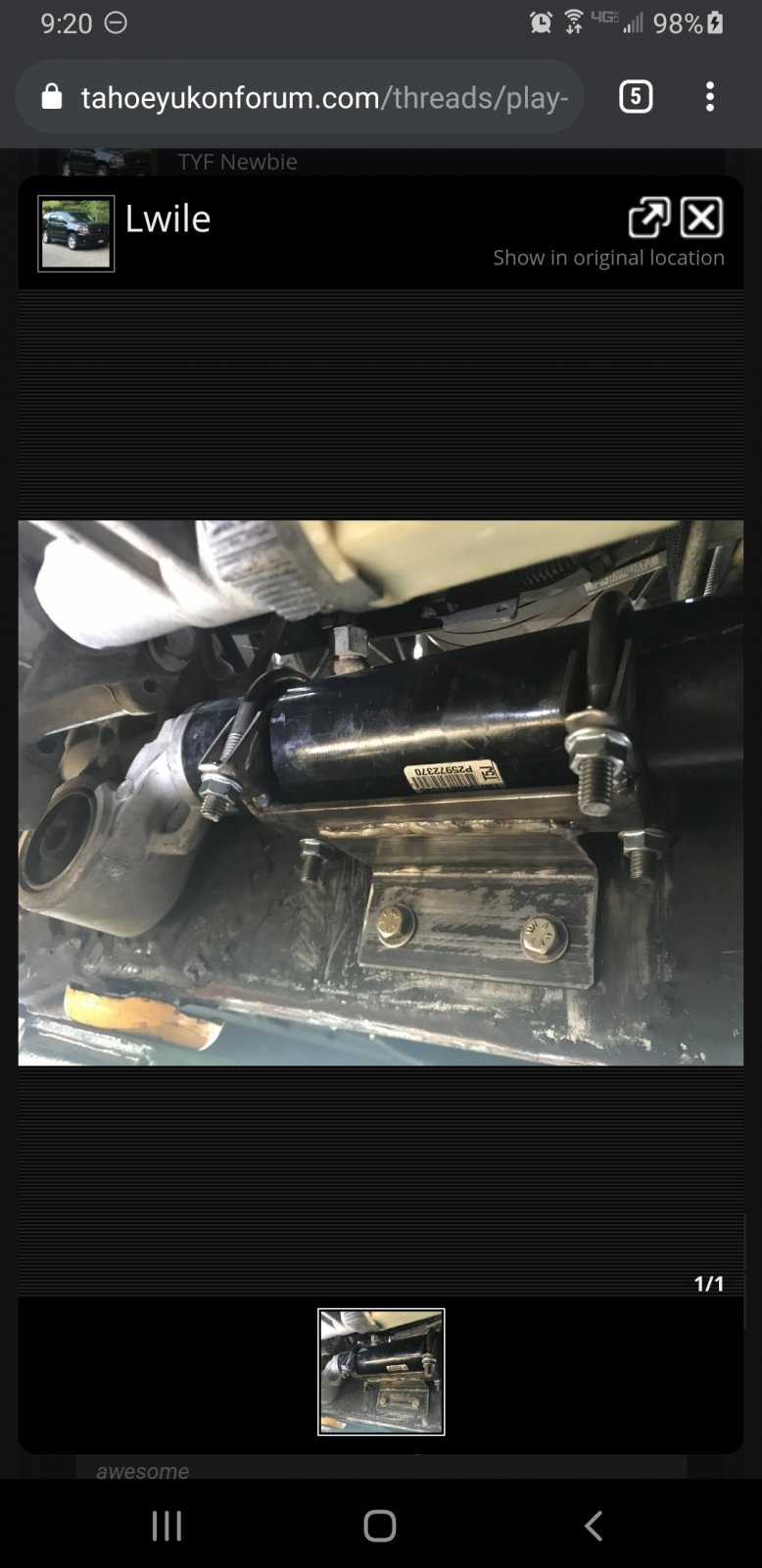

I did this bushing and it kicked my but you have to take a crow bar to the ear and over the face of the bracket and wedge it on there once its on get a 2/4 and a sledge and wack it on keep beating it till its in place. Don't give up I didn't trim mine 0556e4fd37939e1a6430471383fb6c4f.jpg

Screw all that, this thing is not worth it. Rather put my effort in fabricating something like this. It'll serve the same purpose
