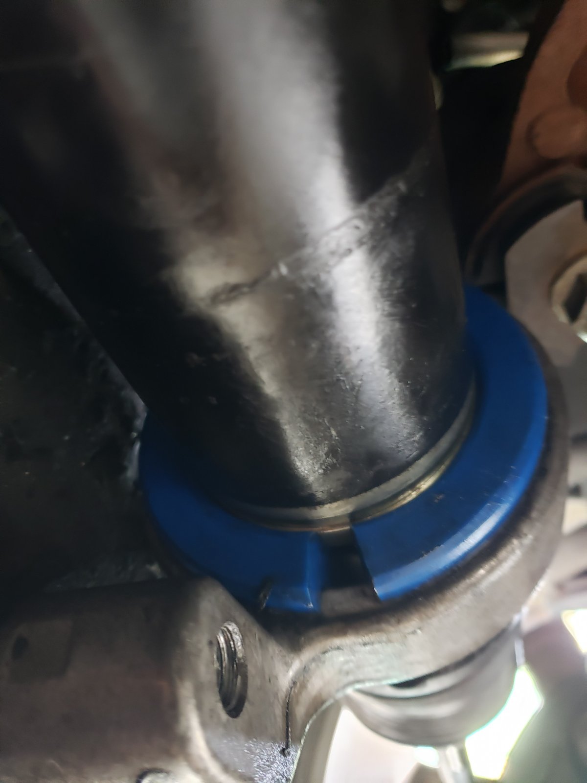

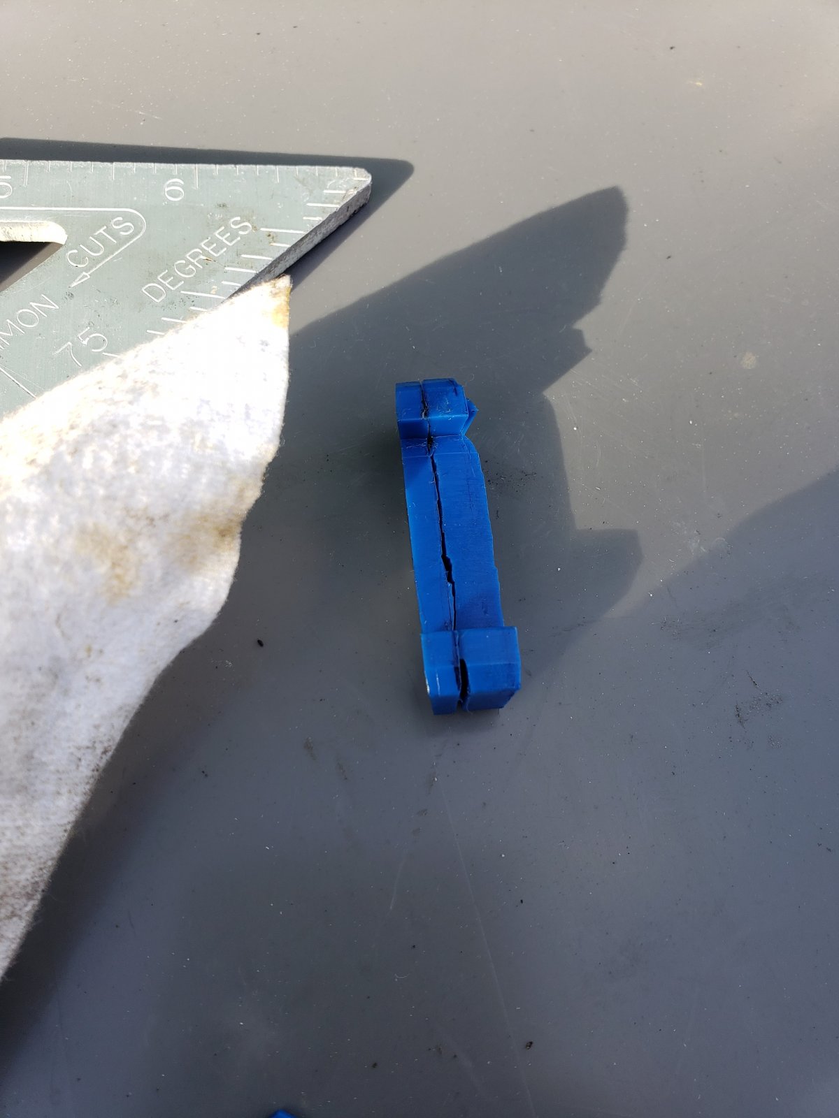

This bushing is much harder than the rubber one. Its pretty hard to get one edge through as it is.
I'm done with this. I DO NOT RECCOMEND this product. I ordered another rubber bushing for $15 that gets here tomorrow.
After i trimmed it it still took a little wrestling to have it sit on on the bracket. Now it wont slide over on the rack. This bushing is just too thick. I would have to trim some more just to get it to slide over.

We also installed mine without trimming but it is a bear.
We used grease and a ranch strap and a hammer and 1/2" drive extension (as a punch) to drive it home.
Wrapped the ratchet strap around the opposite side of the rack and hooked both ends to the bracket with the poly bushing in it... tighten, beat and Fram with the hammer, repeat.
Definitely not for the faint of heart.
