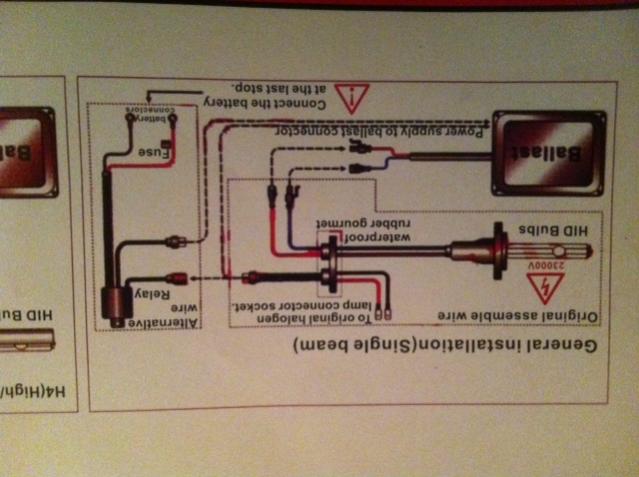

Does this connection make any sense to anyone?
sorry if its upside down. Any help would be greatly appreciated. This is a 55w vvme kit

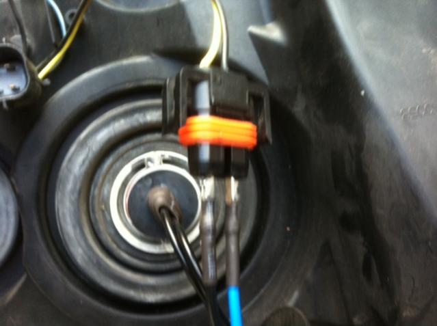

this is what its telling me to do. It turned on but is just shoving the pins into the original bulb connector like this safe?

when i did my fog's lites i cut the connector and pins off and splice and shrink tubbing them together. no problems for 4 yrs. my low beams came with a molded plug. DDM hid's.

on the diagram yes what do you not understand about it maybe i can help you..
and the end when mine came that way i bought some empty H11 housings and basically put the end on.. but you can cut the end off and get EZtaps that you squeeze with pliers to tap into the wires.. i wouldn't cut the stock connector off incase you wanna go back

WHY SPLICE UP YOUR HARNESS? Who did you get that kit from? It should have came with all the necessary components for a true plug and play application. Not sure how much you paid for that kit, but this is the difference between us and other retailers out there. We would have never sent you out a kit like this. this is unacceptable....if you want a plug and play harness you can check out:
HID Power Harnessing Extensions - (1 Pair)
and if you are looking for a relay harness look no further...
R-Tech Single Port HID Relay Power Harnessing - (1 Harness)
