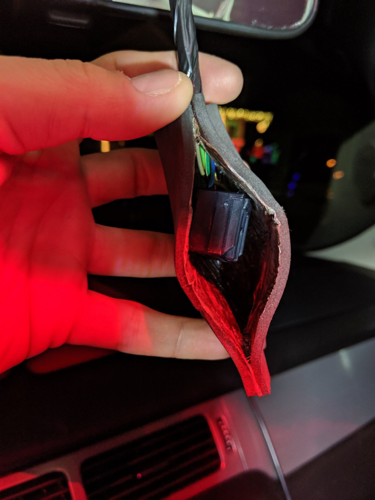

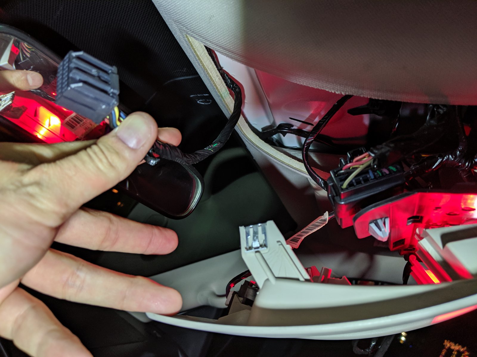

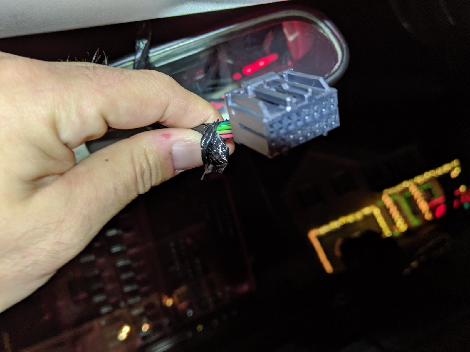

Just swapped in an auto dim mirror and once you pull the overhead console the plug is tucked up in the headliner. Could use some sort of cover over it since it’s just wrapped in electrical tape.
