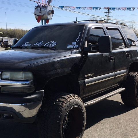

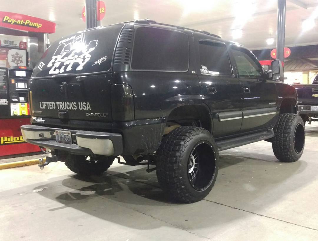

Here is a couple of pics just for reference. The 3rd pic is before the new exhaust work was done.12905020_574848119354330_321818318_n.jpg 10012568_823180301144759_1553295147_n.jpg 1739418_945325312211784_1939705301_n.jpg

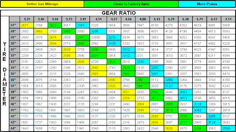

Thats alot of rubber your turning. I didnt notice in your mods that you had your truck regeared. If you haven't had the rear regeared with 35s id have 4.56 put in to help lower your rpms as sumo mentioned.
What are the stock gears? and is 4.56 the best option to change to? How much power would I loose and what sort of fuel economy would I gain from switching to that gearing? Some shows require me to drive through the mountains and I don't want to sacrifice too much power for only a minimal fuel economy gain. Lastly, how much would doing this cost start to finish?

Going to a 4:56 will actually give you some of the power back you might not have even noticed you lost. I think someone posted the chart on a different thread. Its 2:30 am so im not going to look for it right now. Stock i think is 3.53 or 3.73 for you with a stock tire size of 245 75 and your essentially running a 305 or in metric you went from a 29 to a 35 in. You should increase your gearing and it will help your engine spin those tires easier so its not working so hard.
So going to 4.56 gears will increase the power and the fuel economy at the same time???

If i can find the chart today ill post it up for you. If your truck still has the stock gears in it the engine has to work harder to maintain the same speeds as it would with the stock tire size. Which in turn will cause the engine to burn more fuel. If i can find the chart or if someone else has it and will post it there is an optimal gearing for what tire size. Go too high and you will gain only power go to low and the engine has to work harder.

Gears will make the most dramatic difference, e-fans will help a little but its a lot of work and money for minimal gain. Unless your fan clutch is bad i would not bother. When I had a k&n intake i didnt notice any difference in mpg, it just looked cool and didnt require me to be buying new filters ever again. New O2 sensors with that kind of mileage will likely help, i can't believe they made it that long. Is the converter getting clogged? Other than running some fuel system cleaner through and going light on the pedal im out of ideas.
