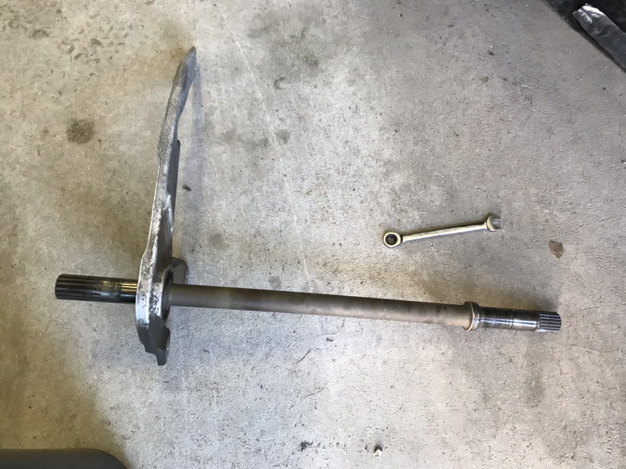

Removed ball joint nuts, pulled caliper bracket and rotor and removed CV shaft nut. Removed the 6 bolts on the inside CV shaft so I could pull that thru hub bearing. Spindle broke free pretty easily.
