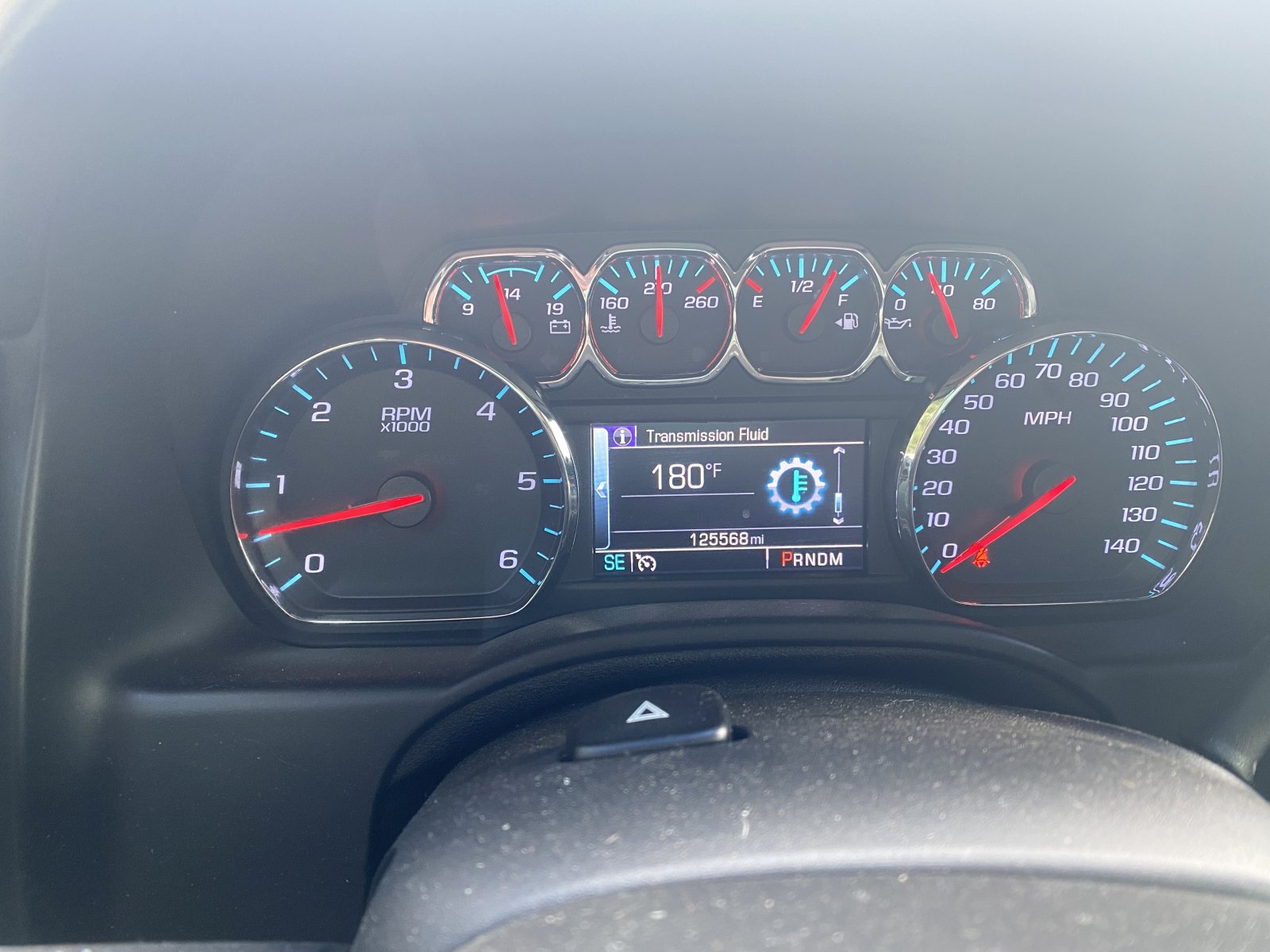

Thethirdtwin After climbing a mostly 6% grade for 16 miles. I’ve been in the same location with thecopcar after upgrading the external cooler. It topped 200.
