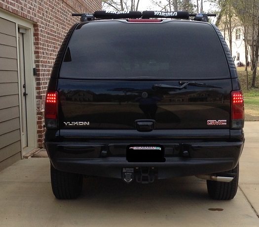

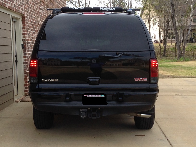

All some nice leds tails, i have the last ones you posted w/ half park and half brake. I like it and have 0 issues going on about 4 years installed. All leds still light up.
Yeah I definatly did not pay that, 140 is what i payed, that was just for reference. I would say personally I like them all and none I have had on my vehicle's have hyper blink, but I prefer the full led over the half.
