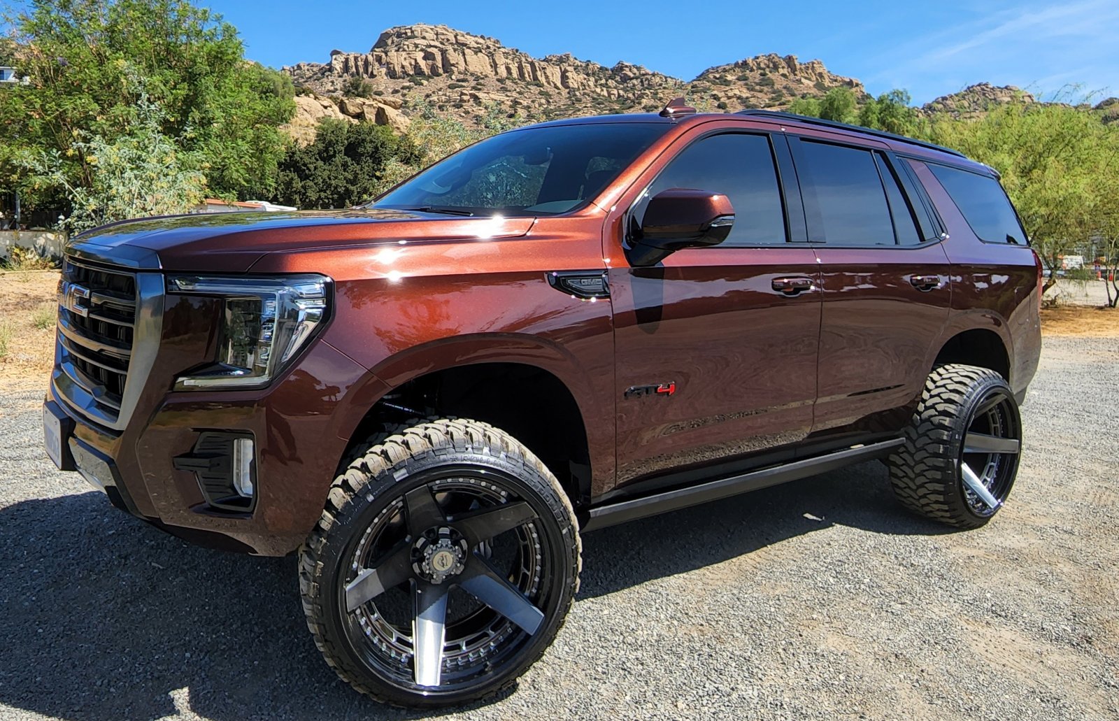

It’ll crank up to 4.5” but I think that might be a lot.
This is what it looked like on a customer build. 24s on 35s
I have the Ready-Lift 3" SST lift, and it's the right amount of lift for me without compromising parking garage clearances. with 33's and the 3" lift, my height comes in at around 6'6".
