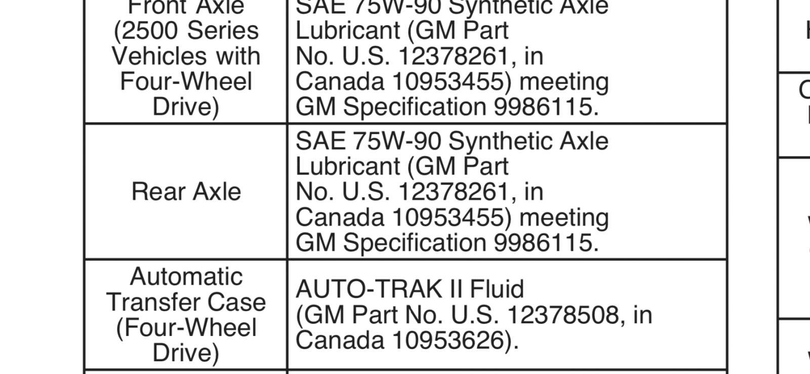

So,...did we ever decide whether or not to use an additive on a G80? My shop just added it to my G80 rear along with DELVAC 1 75/90. Did they mess up?
The manual for your 2007 Tahoe does not call for additive, just 75W-90 synthetic gear oil. GM 12378261 has been superseded by AC Delco 10-4016 if I’m not mistaken which has no additives.
