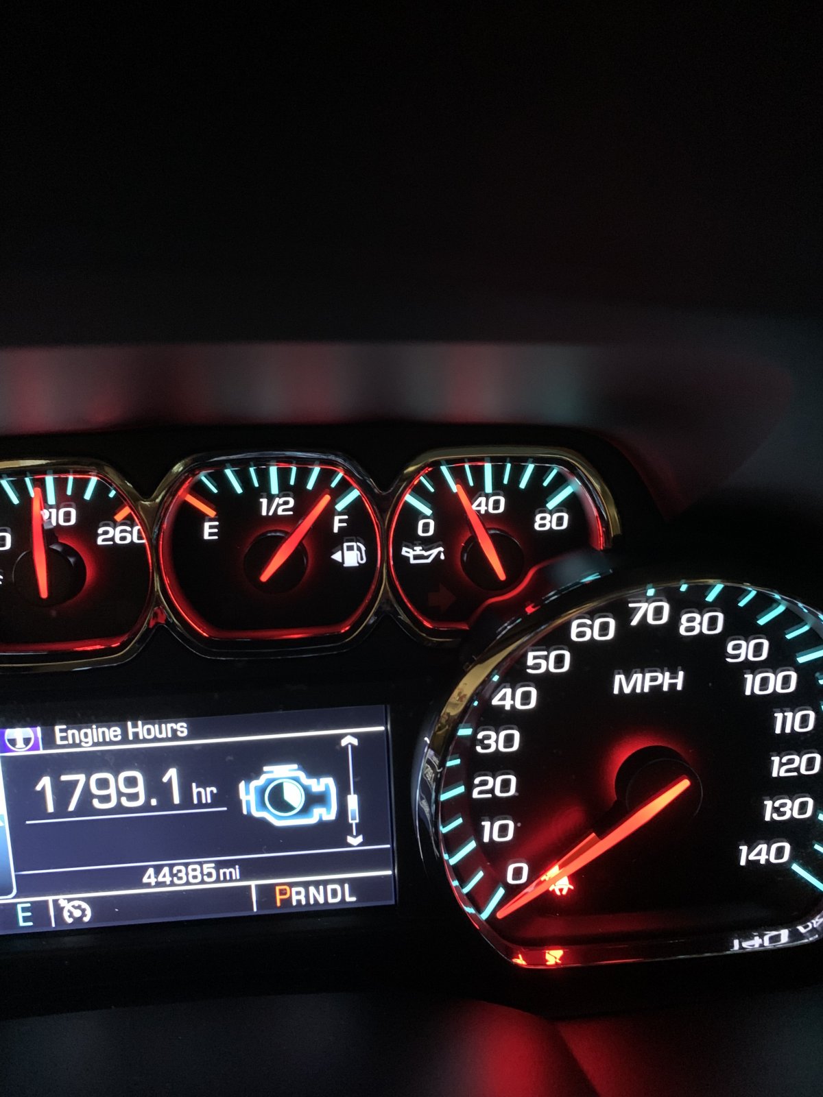

The Solus I have won’t read actual oil pressure so I can compare it to the dash but it does give me oil pressure switch voltage which is sitting at 1.41-1.52 with the dash showing oil pressure at 30psi and coolant temp at 158 degrees Fahrenheit

That sender voltage tracks with mine ('04 5.3 Flex):
Gauge Oil Sensor
Pressure_ Voltage (v)
0 (engine off) 0.53
35 1.69
40 1.86
45 2.06
50 2.29
60 2.41
That doesn't mean that your sender isn't under-reporting the actual oil pressure, though. Only way to verify that is with a direct pressure gauge.

I’ll double check the voltages tomorrow. I’m trying to do all the diagnostics I can until I can afford to get a mechanical gauge or just replace the sensor
