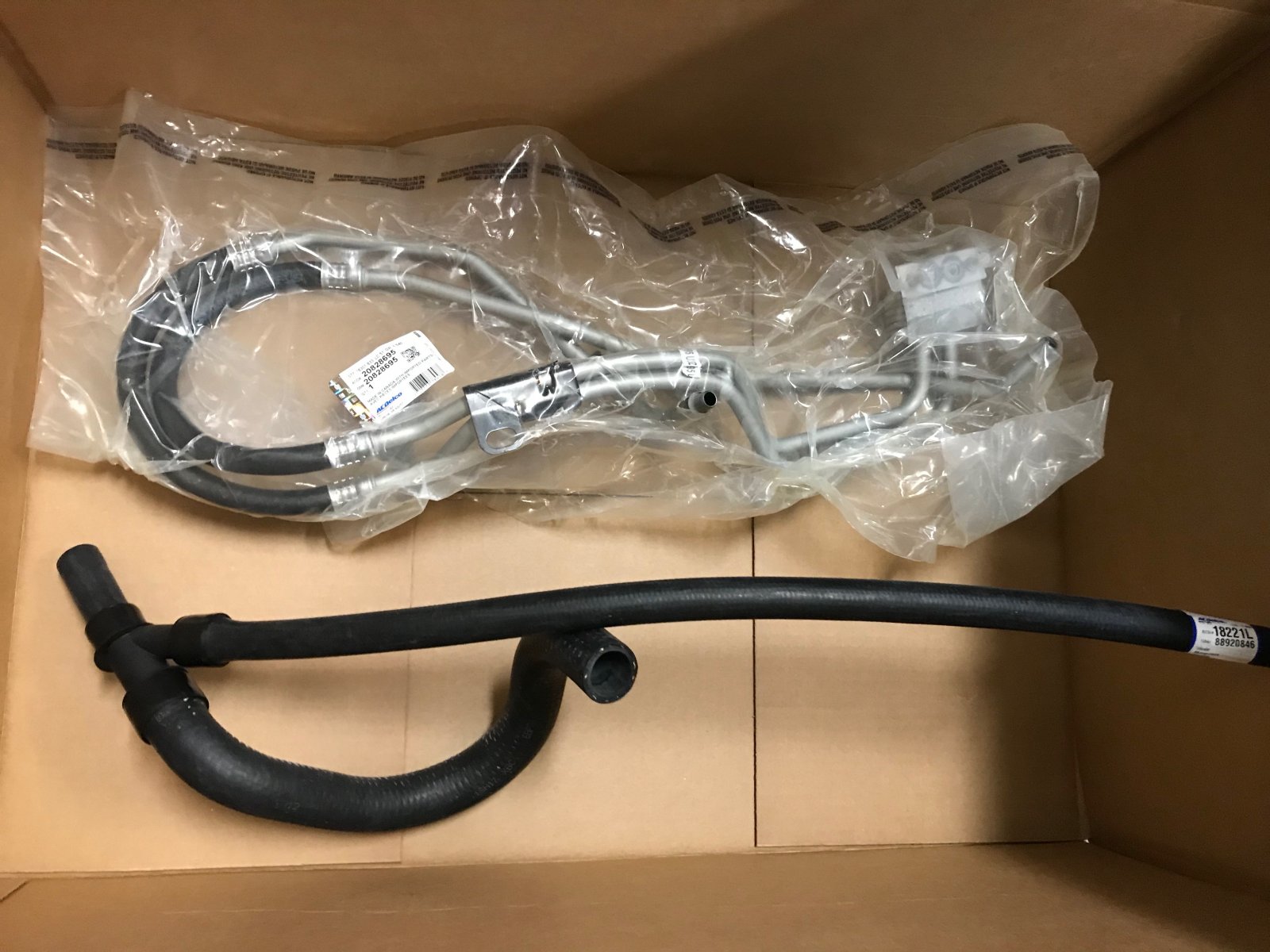

Some more goodies showed up while I was gone
AC Delco professional water pump, also have 160 degree thermostat.
Heat sleeve for plugs, not sure if I am going to use it, will see when installing
Engine cooler lines, Transmission ones have been changed 2 weeks ago, and the Y connection heard it was weak so got new one.
Don't have picture of but all new AC Delco radiator hoses.
Just FYI... Dorman sells this...
https://www.dormanproducts.com/gsearch.aspx?year=2008&make=Chevrolet&model=Suburban%201500&origin=YMM&q=Y connector
Which is a metal replacement for the plastic Y-connector down by the thermostat housing.
I am a fan of replacing plastic with metal when ever possible.. still waiting for Gruven to get the metal heater core Y-connectors into production.
I was just looking for something like this, does anyone make full silicon hose kit?
