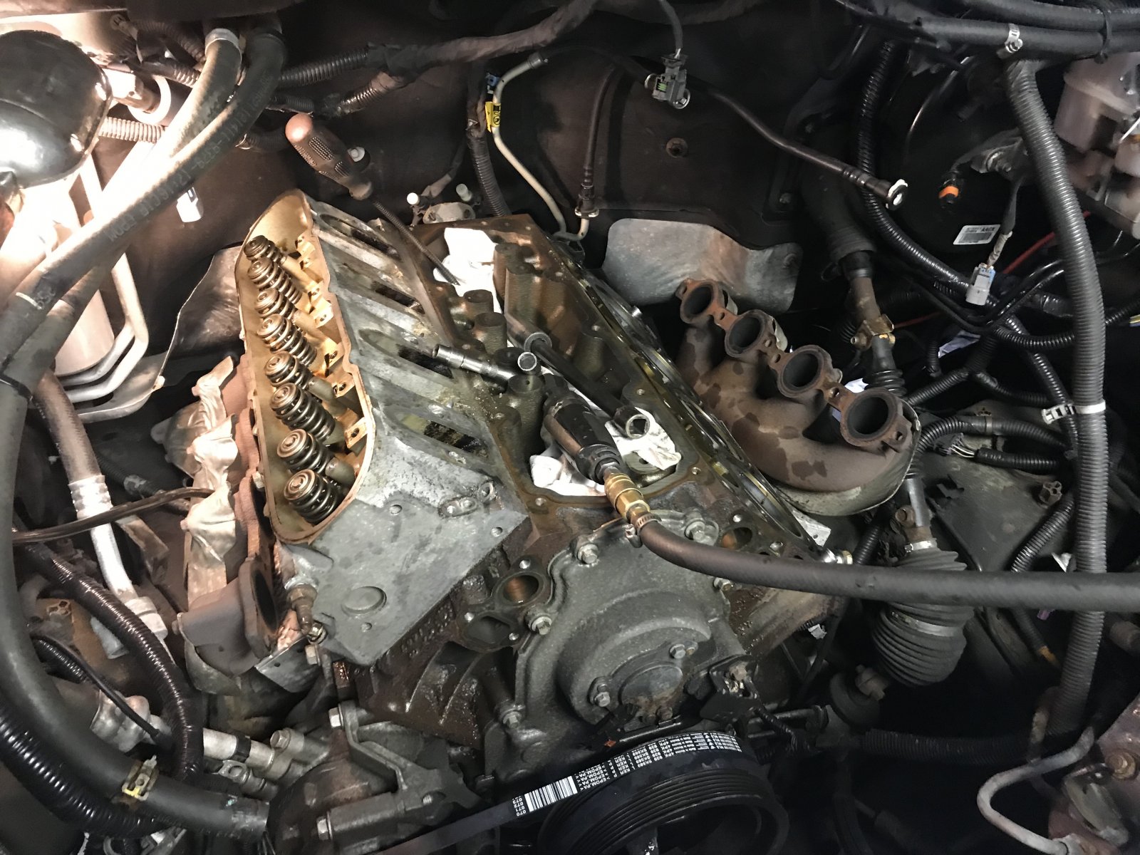

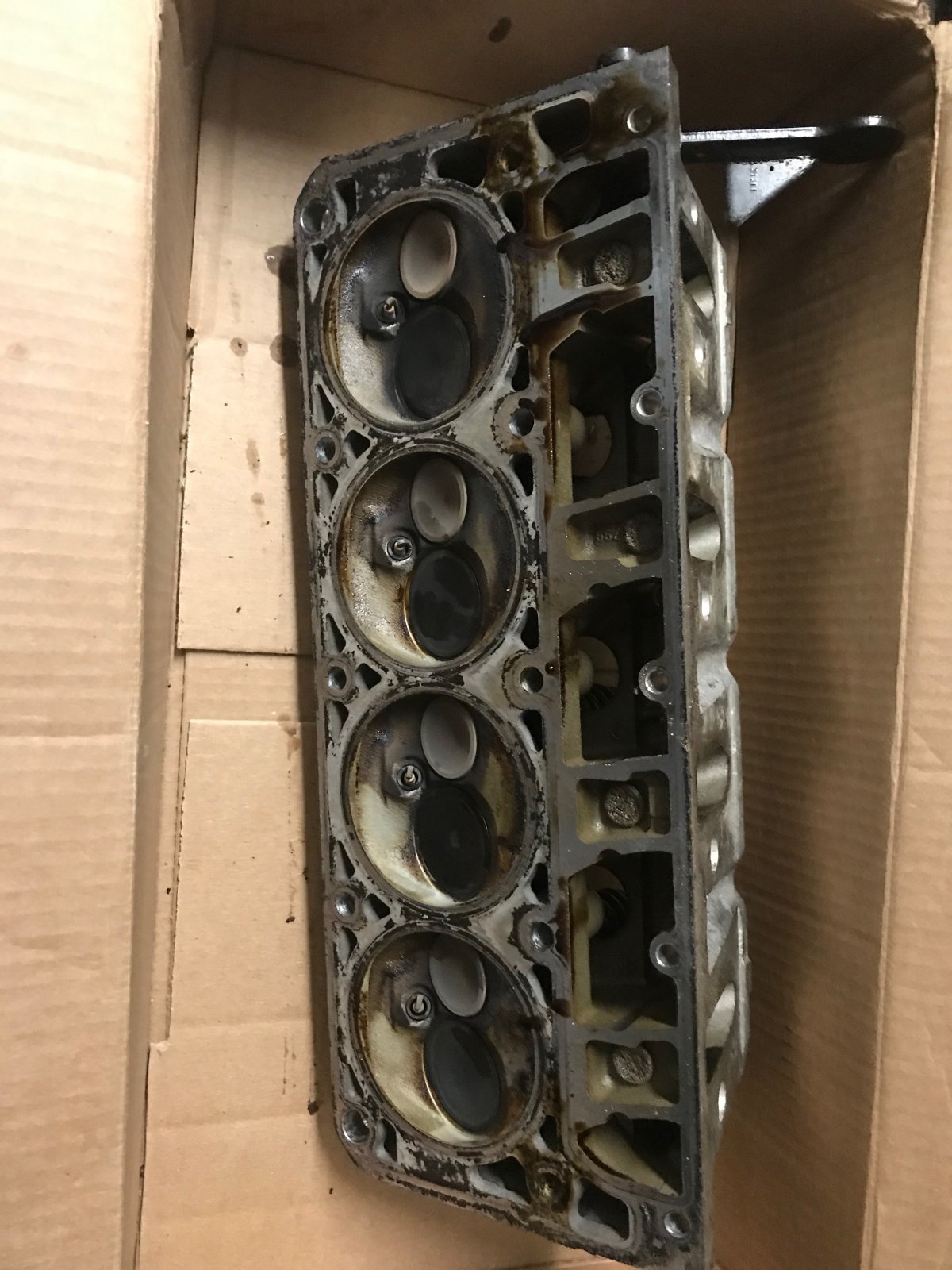

Now after seeing those head gaskets how in the world do guys reuse them?! Those pistons look clean.
31. Port and polish heads lol..j/k..
Sent from my SAMSUNG-SM-T377A using Tapatalk
reuse head gasket? hell no on this build, pistons are clean but my truck has only 45K

Only one broken bolt on exhaust manifold, Y pipe was a bit pain ended up cutting it off. Everything else no problems so far.

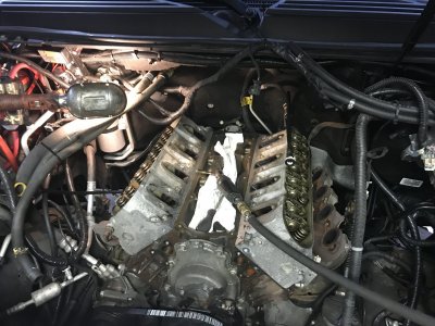

Not bad, good thing you took the heads off, easy fix... Hell of a lot easier than trying to fix it on the truck.
Definitely don't even think about reusing head gaskets as cheap as they are lol... Which ones are you going to use? Replacing most, if not all gaskets I hope?
This truck is going to be awesome when you're done, you will not be disappointed... Torque converter is going to make it drive way different in a good way and all that extra horsepower will be moving that 6k LB beast pretty quick.
Congrats, good luck and keep the pictures coming...
Heads were coming off anyway for new lifters and trays, all new gaskets and bolts, actually have two sets of gaskets one from BTR and I bought AC Delco.
