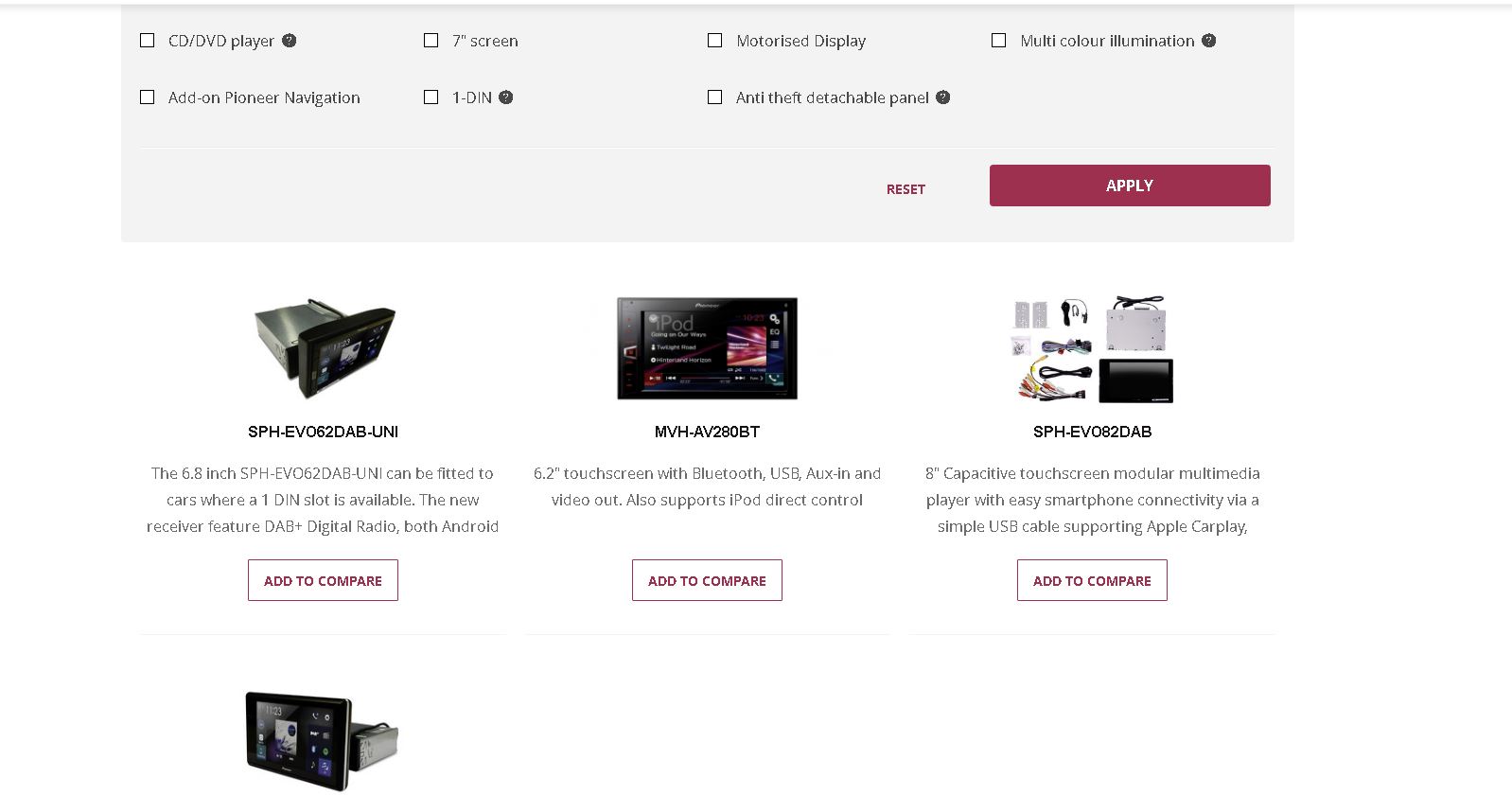

some of the pioneer evo series are single din but have a 7" or 8" screen on the front, one of them is completely modular, the alpine 1207 is vehicle specific but could maybe be worked in, just gotta think outside the box, some marine radio's are 1.5 din, alpine halo9 is also a single din with 9" screen, they also have ilx units that are single din with a larger screen in front
