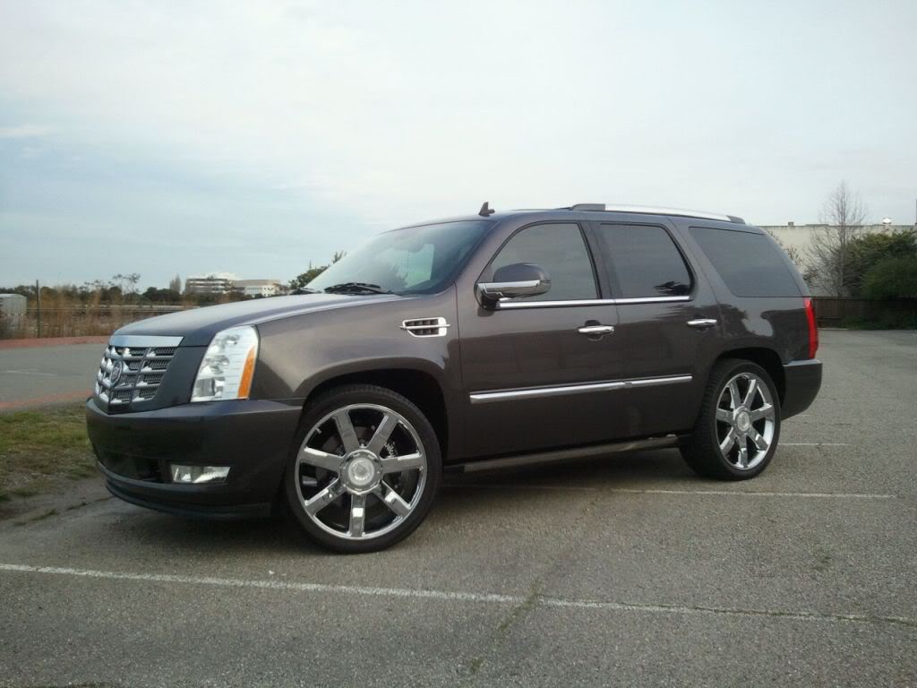

48 Miles on the truck I couldn't take it anymore Had to lower it
i wanted to do steps on the truck just to feel the difference.
So today i did the front belltech spindles
Front swaybar
and rear shock extenders
Even with my alignment off the djm front bar and spindles make the truck feel a lot more in control. In the rear im really suprised how better it feels. Its not as jarring and more smooth and this is with the stock rear springs in only thing added was shock extenders. Im guessing the shock angle is better so has a better chance to work.
I cant wait to put the rear belltech springs along with the djm trailing arm relocators, spohn panhard bar, lower spohn a arms and last the rear djm swaybar!! Thing will feel so much better.
riht now

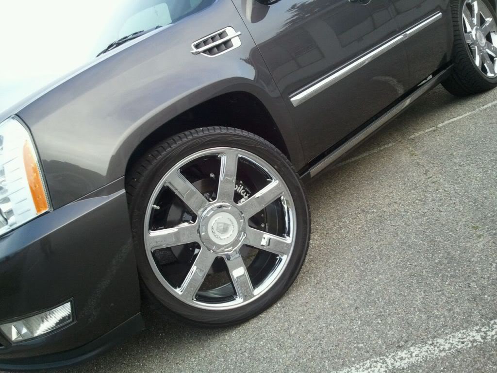

FRONT 33 7/8 from ground to fenderlip
REAR 37 7/8 From ground to fenderlip
LAST but not least!! esky 24" chrome replicas with 305 35 24 Yokohama tires
