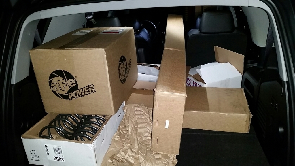

Upper spring with lower spring insulators are 3/4 of a inch thick. ill post pics when i do mine. IM just wrapping the top/bottom coil with heater hose.

Ride height rear shocks are at 19 3/4 inches I'm going to try to keep it at around same level so mag ride stays within spec.
This is horrible though. Front is 35 5/8. After 2 inch drop will be 34 to 33 5/8 I'm fine with that but rear I need like 4 to 4.5 to look right. I'm going to put in the 5305 belltechs. If that doesnt get me low enough then I'm putting my 6" spring in like I did in my old escalade so gets down more.
