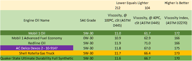

A few months ago I noticed that ACDelco's website https://parts-catalog.acdelco.com/catalog/catalog_search.php was showing a new oil for 4WD vehicles when I ran my VIN. The earlier 4WD long trucks came with aluminum engine blocks and thus see more expansion than cast iron blocks during operation. I'd been a little concerned that M1 was too thin, the motor noisy at start up which is "normal" and then quieted down. It also ran so much better with 4,000 OCIs compared to 5K-6K changes.
Anyhow, I researched the oil as best I could and found an SDS sheet with some specs and it showed higher viscosity numbers than the regular Mobil 1 I've been running. The oil is made by Phillips 66 Lubricants.
To make a long story short, getting hold of this stuff was not easy at first. First two companies had large minimums, one wanted me to buy 12 bottles, the other 195! Well, after more searching I found it down in Palm Beach county for $22 a bottle and it comes in case form, 3 bottles.
Since the change there is no more rattling cold motor starts and the oil pressure has actually increased all across the spectrum. I would say when hot, it is running about 3 psi more than before and a lot more when cold. I've NEVER seen the oil pressure gauge so high before. Idling at temperature is about 29 psi according to the Tech-2.

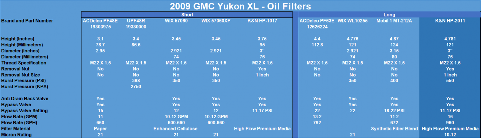

A while back we were all talking about pressures and I noticed that the Mobil 1 oil filter lowered my oil pressure, using the M1-212A and would alternate based on access and sales with the K&N HP2011. These are the long filters. Well, the K&N definitely allows for a higher oil pressure and that one inch nut makes removal a breeze (shhh, don't tell anyone that we use it to tighten the filter too!) I think the K&N gave about 2-3 more psi too.

more viscosity but still listed as 5w-30? i thought it was best to run oil with higher zinc

Your oil pressure numbers allude to you having an iron block motor? I've never seen the needle past 50 psi that I recall, cold, hot or otherwise. The bypass spring in the M365 pump is 33 psi.

Just wondering are you noticing an increase in piston slap at idle with the higher viscosity? I am loyal to mobil1 but got caught up in the marketing for valvoline full syn and gave it a shot. same 5/30 but absolutely had higher gauge readings and to my surprise more noticeable piston slap at idle. I changed back to mobil 1 within 100 miles and the slap went away. i like oem products, wait now i get it! i thought your op was $22 a qt but now i see the "bottle" must mean 5 qt. thats not so bad.

I was loyal too. Only switched off when I ran a Jiffy Lube back in the 1990s for a spell. No more noises from the engine due to "thin" Mobil 1. That's why I switched.
