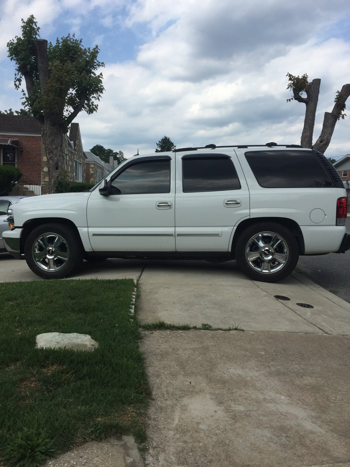

Alright, so I have a chance to trade straight up for a set of NNBS LTZ 20's. My BIL is trading his 07 LTZ Suburban in on a brand new Tundra and told me if I wanted anything off the truck that would swap, I could do it. I'm very tempted to swap rims/tires with him. The only thing stopping me is the fact that there aren't many LT tires available in 275/55-20. There are some XL load range (Index of 117) which is a 4 ply tire, but I was hoping to get at least a 6 or 8 ply before we start towing in the spring.
Should I go for it and swap them out? I think they have a little more tread but regardless, the tires will end up being replaced within 6 months anyway...
EDIT: Also, I peeked under the truck because I'm getting ready to order the fluid, filter, and corvette servo. Looks like I have the deep pan (not sure if they all do?) but I started googling on the trans fluid changes. Does the exhaust y pipe need to be removed on these or is that only on the NNBS? I don't want to get into trying to remove a 200k mile old exhaust because shit's gonna start breaking at that point...
Lemme know so I can order this stuff and get things going. Thanks!!
