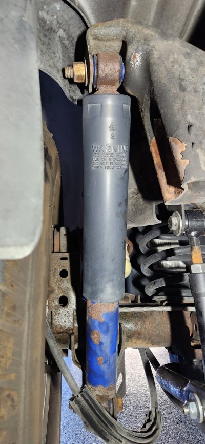

Ok, good luck with that; I hope it works out. Nivomat is the technology developed by SACHS, and doesn't necessarily show up as a descriptor on every brand that offers it. Based on what I've seen I still don't think yours came with Nivomat technology for the rear shocks; I could be wrong.
I'd be curious if anyone else with an '05 or '06 4WD XL on this forum has ZW7 AND G65 on the RPO list, or if only the ZW7 code shows up.
If your rear shocks were changed, then, perhaps so were the springs. Better start researching those.
Good news..... I carefully, removed the part # decals off my springs....
They are OEM original. ( whew! )

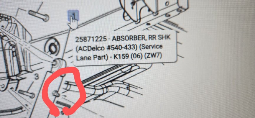

ZW7 is the designation for Nivomat / Sachs shocks...... But ZW7 isn't the only code....
This website designates all codes.....
